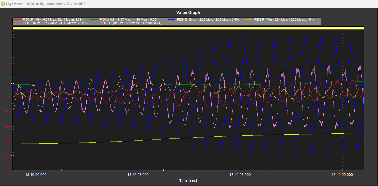

Hi @Leonardthall
I have retuned the aircraft and there are high frequency oscillatory patterns in the desired roll and pitch as shown in the image below.
Also the PID N and PID E are this
I am like concerned about these oscillatory patterns in desired roll and pitch
Please comment on this are these patterns common because i have never seen this in my other drones.
Can you attach the log from the graphs you just showed?
