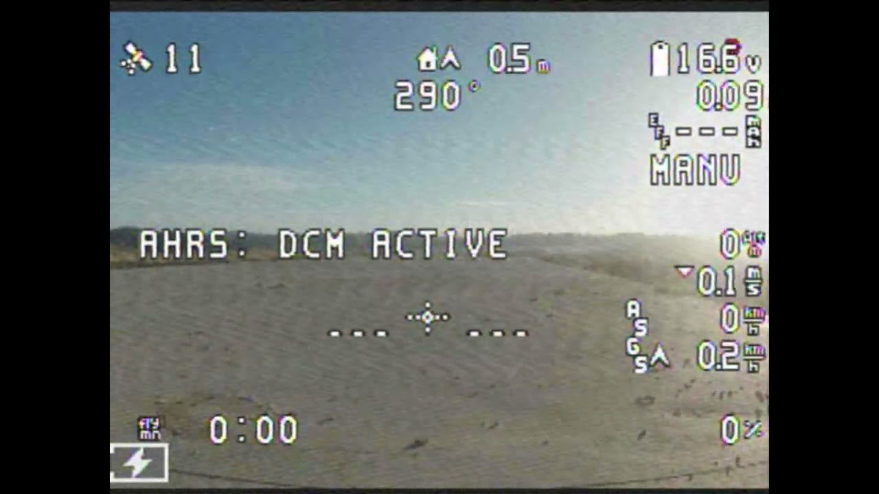

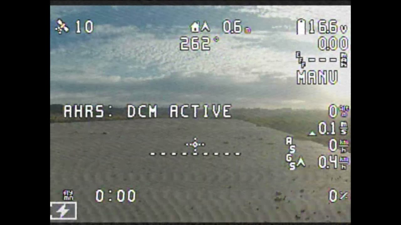

Looking at the OSD footage from the good and bad flights, I notice that shortly after launch when I see the “EKF3 IMU0 yaw aligned” message, the heading jumps by only 3 degrees in the good flight, and in the bad flight it jumps by about 70 degrees. In the bad flight it returns to the same value it had before takeoff.
Here are clips of the pre-launch section for each flight.
Good flight:
Bad flight:
For reference, the concrete airstrip runs at about 70 degrees, so my direction of launch is about 65 degrees.
In both cases, the heading starts off near the default heading of north (eg. 356 degrees) after powerup and doesn’t change much until the plane is armed, at which point it shows “DCM active”, the heading jumps to about 260 and starts to slowly drift a little. I think this is probably normal right?
As soon as the takeoff roll starts, the heading jumps to the correct value of about 66 degrees, and continues to look correct for a while after lifting off.
After about 15 seconds the message “EKF3 IMU0 yaw aligned” appears and the heading changes again. In the good flight it jumps from 10 degrees to 7 degrees. In the bad flight it jumps from 64 to 356. In the other “not quite as bad” bad flight it jumped from 46 to 99 degrees.
In the good flight, the plane happened to be heading very close to north at the time of the first EKF alignment, so even if the value it jumped to was poorly calculated, it would still have been close to the correct value just by lucky chance. Maybe that helped make the good flight a success.
