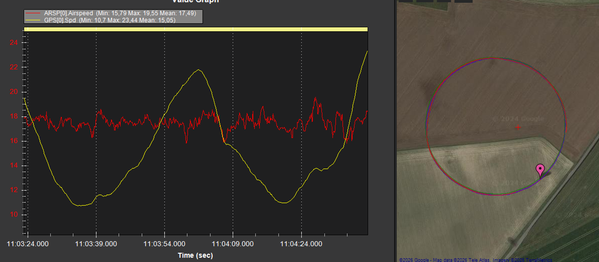

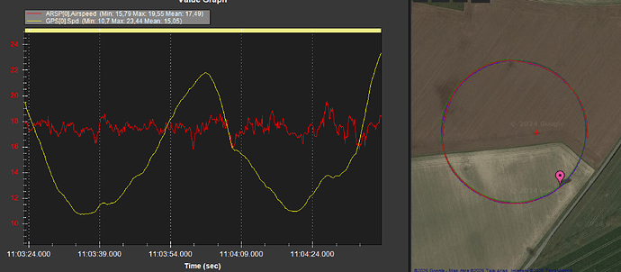

A few days later, I conducted another test flight. The aircraft completed 5 circles with a 70-meter radius, and the flight lasted for about 4 minutes. The ARSPD_AUTOCAL parameter was enabled while circling. I also performed a preflight calibration before takeoff. However, while the offset value changed, the ratio value remained exactly the same.
Can we consider the pitot tube calibration successful based on this, or should I perform another test flight? I can share the flight logs if needed.
You can check this yourself and make any necessary corrections by comparing the airspeed and ground speed while loitering. The airspeed (ARSP[0].Airspeed) should remain roughly the same and correspond to the average of the minimum and maximum ground speed values (GPS[0].Spd) .
Here is an example of a sensor that, in my opinion, is reading 0.5–1 m/s too high.
