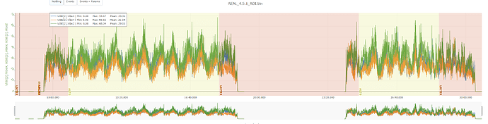

Hi to everyone,
in order to integrate the remote ID we updated the firmware of our octacopter from 3.x to 4.5.1. We instantly realized that in our general missions, which consists of circle path in auto mode, generated with spline way-points very close to each other and placed on a polygon inscribed in a circumference, the copter was not behaving as usual, i.e., between each waypoints couple the copter, annoyingly and without need, pitches toward the center (please, note that we need also to set the ROI to the center of the circle). This behavior is very bad to watch and causes problem in our acquisition.
By trying to replicate and fix the problem with the simulator, we realized that it happens for all the firmware from version v4.1.0, while early versions, e.g., v4.0.7, provide smooth mission flight without pitching as we were used to. Therefore, we can only assume that the problem is due to the S-Curve introduced with 4.1.0 firmware, which I understand it cannot be deactivated through parameters. Note also that we tried to modify most related parameters, e.g., WPNAV_XXX, PSC_XXX, etc. without success.
This behavior is also more critical when the ROI is cleared and the copter points the nose toward the WPs. In this case the UAV seems “to limp”.

  1. You have excessive vibrations which can badly affect the control loop.
  2. Sadly spline waypoints will have kinks that cause such leans
  3. Loiter radius shouldn’t have large errors
3.x is very old. There were changes to PIDs in 4.something after which it was recommended to tune again for improved performance (automatic migration is “good enough”). Going from 3.x to 4.5.x is a much bigger jump so tuning again is even more important.
I would recommend using Ardupilot Methodic Configurator to go through the configuration process again for optimal performance.
