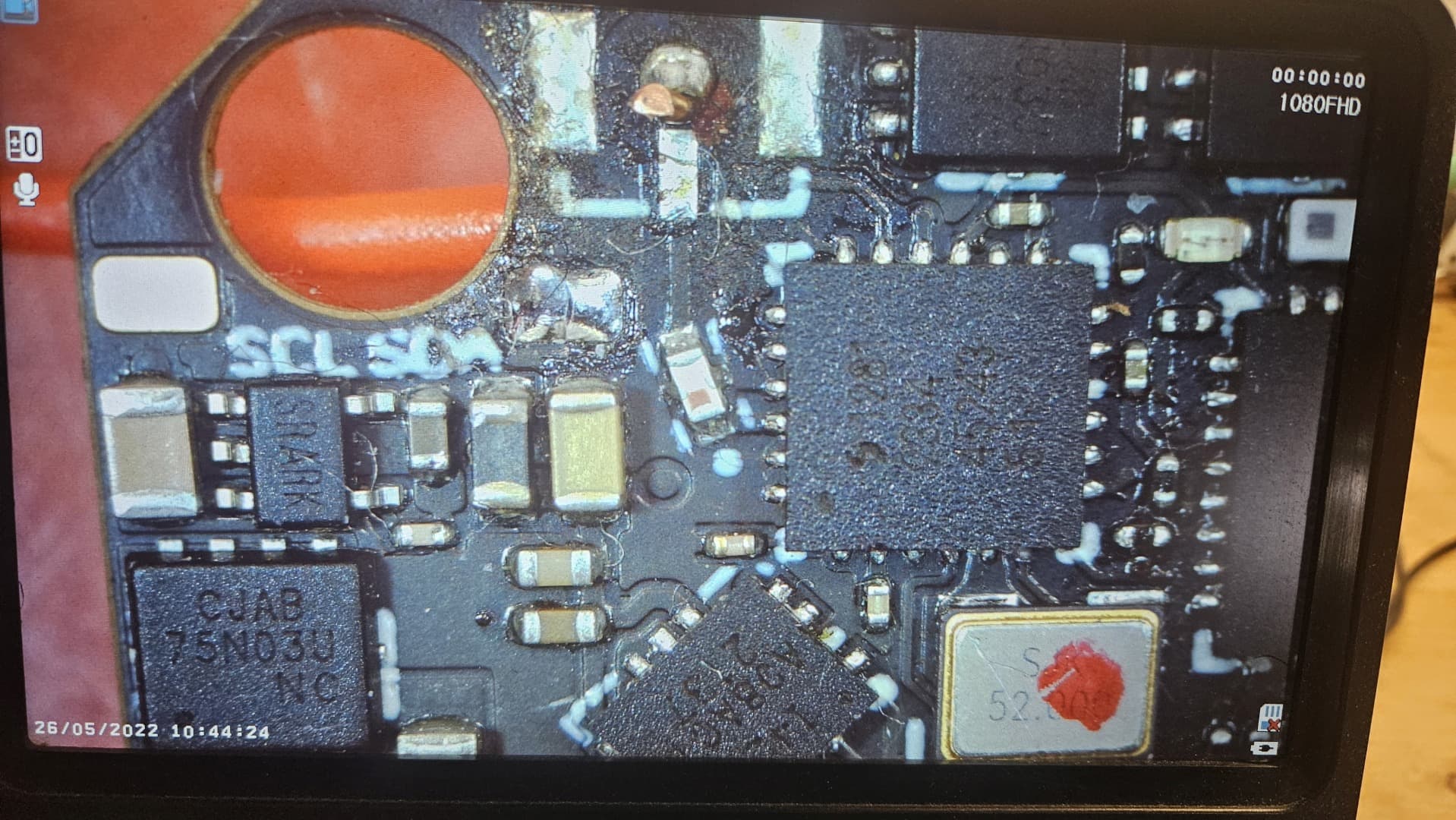

@andyp1per as you indicated, the LEDs are connected to UART6. I have added the GPS leaving compass I2C wires off for now. GPS is working with BetaFlight.
@andyp1per I see that you have checked in the final release candidate: ardupilot-firmware/BETAFPV-F405/pavo20pro-4.6-gps at main · andyp1per/ardupilot-firmware · GitHub
Does it requires I2C mod or any other hardware mods before installing?
The GPS version requires the I2C hardware mod. There is a non-GPS version there as well which uses the board as shipped.

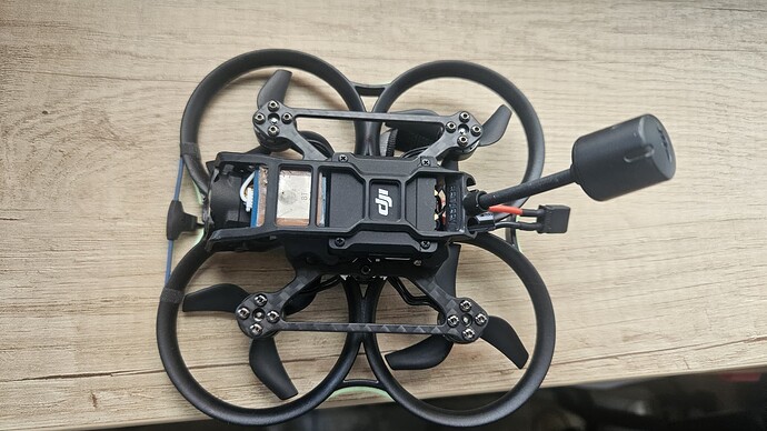

I’ve had some success with mounting on top and using mumetal tape - getting 3D fix, still some issues though.

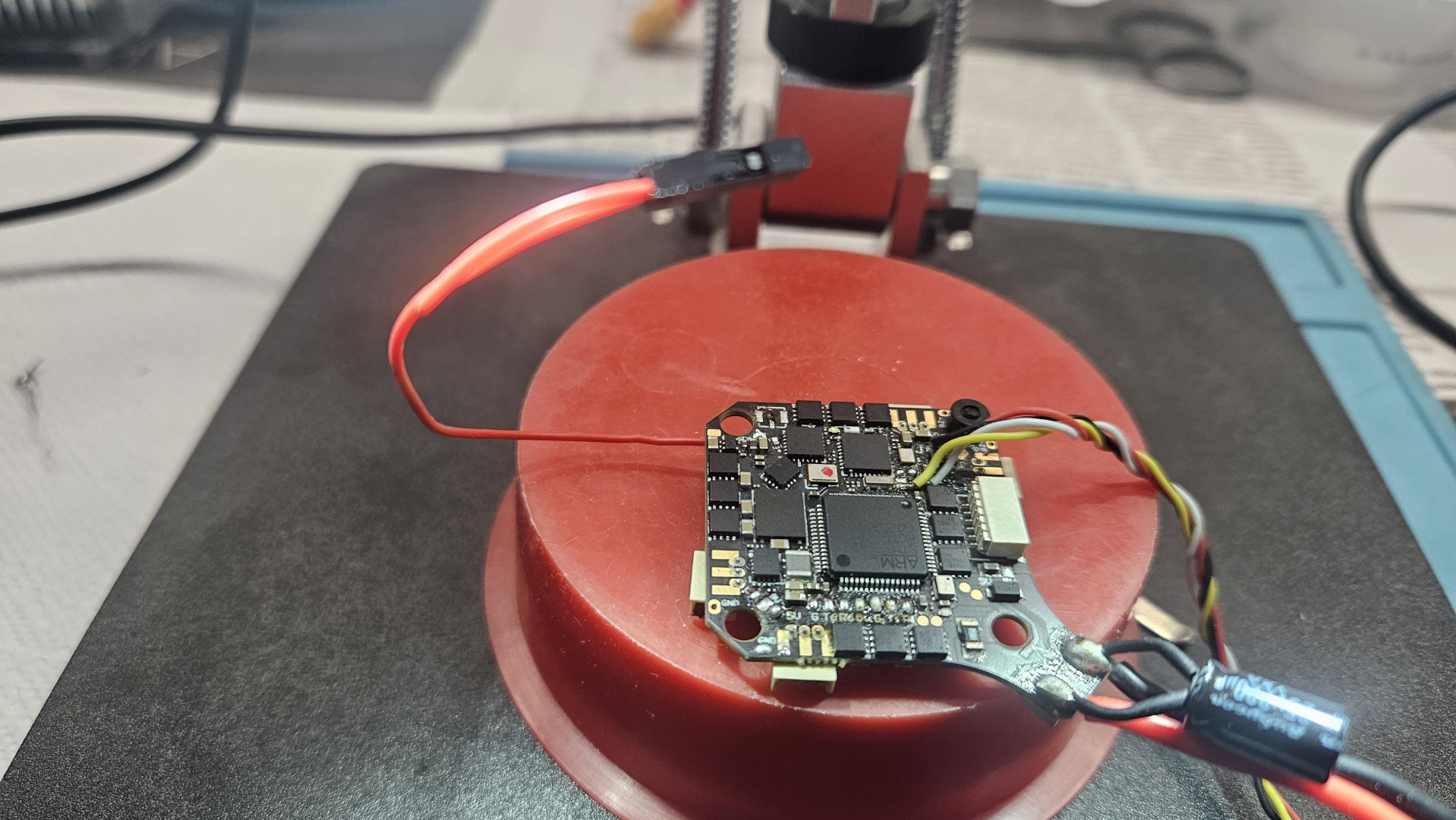

After some time I’ve noticed updates to this thread - one remark - there are populated pins for I2C1 of STM32 on F4 2-3S 20A AIO FC V1 board that could be used e.g. for compass - see attached photos. I’ts PB9 for SDA and PB8 for SCL.
Betaflight uses only one of these pins (SDA/PB8/B08) for PPM but it’s not documented on BetaFPV page.

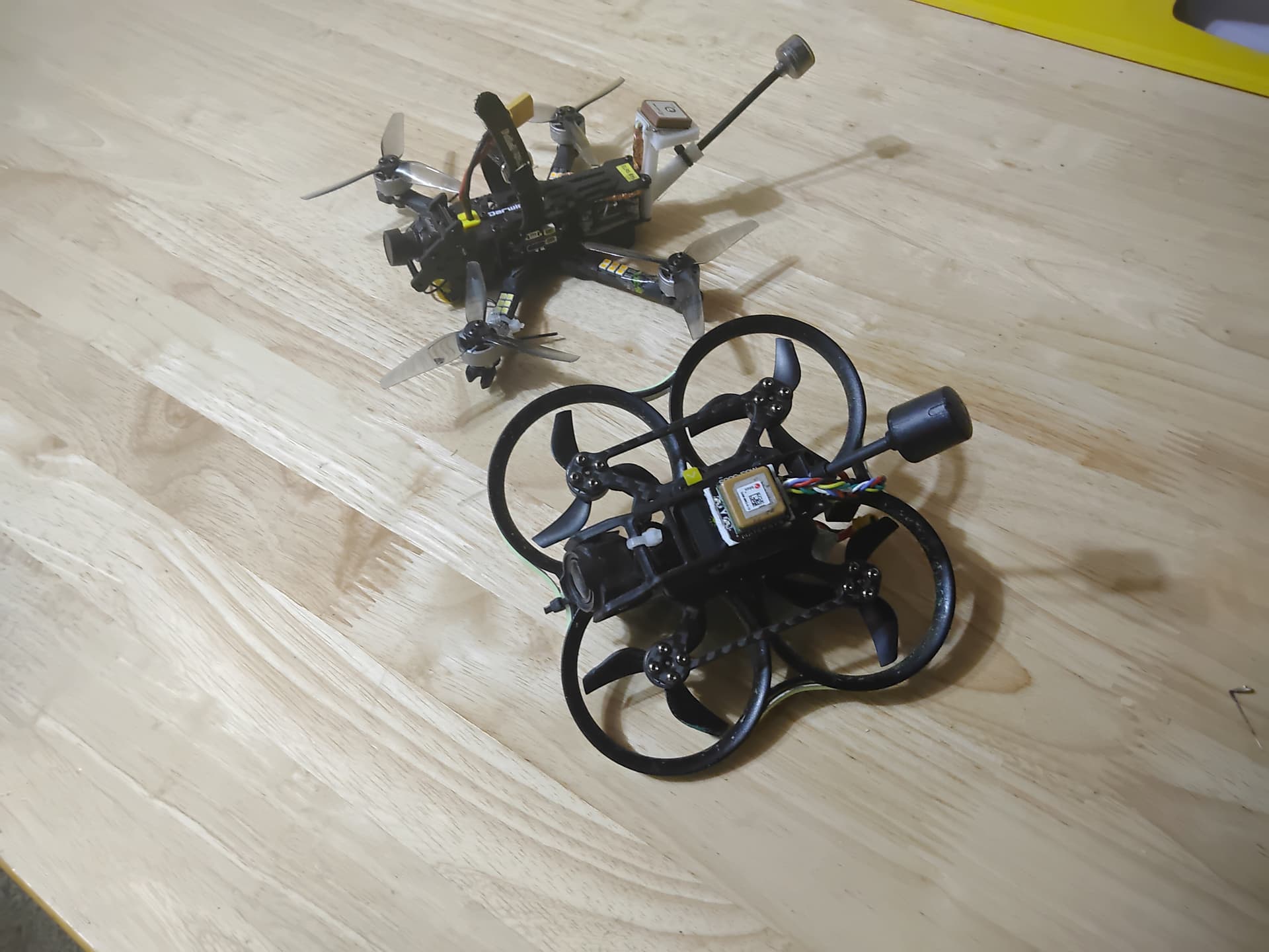

And this is my current setup of Pavo20 Pro with working GPS and O3 unit. But you’re right that getting GPS lock takes longer than I’m used to.
