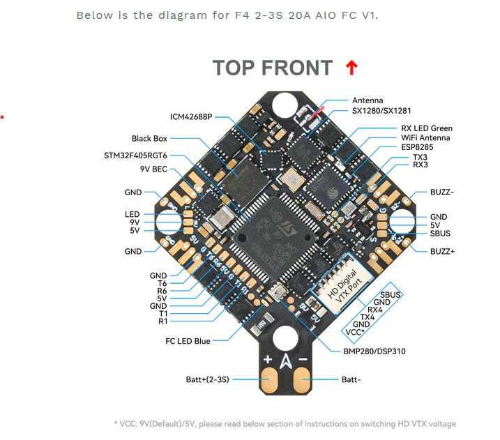

I am shopping for a small quadcopter, and the BetaFPV Pavo Pico seems to match the Ardupilot requirements, but I don’t see a firmware listed on the download page for F4 2-3S 20A AIO FC V1.
This particular flight controller have following spec:
CPU*: STM32F405RGT6 (168MHz)
Six-Axis: ICM42688P (SPI connection)
RX: Serial ELRS 2.4G Receiver
RX firmware version: BETAFPV AIO 2400 RX ELRS V2.5.2
Antenna: Enameled wire
Blackbox Memory: 16MB
Sensor: Barometer(BMP280)
Can someone point me the firmware fitting this FC?
FC: F4 2-3S 20A AIO FC V1 – BETAFPV Hobby
Pavo Pico: Pavo Pico Brushless Whoop Quadcopter – BETAFPV Hobby
andyp1per
(Andyp1per)
April 11, 2024, 11:02am
2
It doesn’t look like we have a port for that but it looks very similar to the 1S AIO board I did. Its worth possibly trying that to see if it works. BETAFPV-F405

Thanks Andy. When you used BetaFPV-F405, did you disabled logging? Board blackbox memory is only 16MB (no-SD slot). Did you disable anything else?
andyp1per
(Andyp1per)
April 11, 2024, 12:42pm
4
It has a flash chip I think
