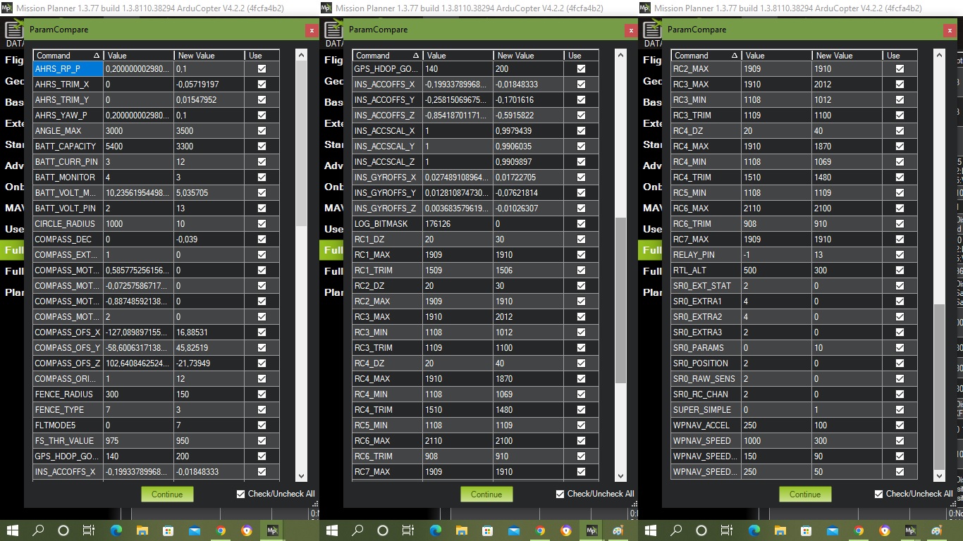

I post changes between original MP settings from APM and what is now on Pixhawk. Maybe I should change something.

I wonder what was with transmitter RC3 (previously 1012-2012 and now I got 1108-1910). And in the middle is about 1500

Strangely but after that Initial Parameter Setup (props, cellcount, bat volt) and saving them hexa flies on first test in stabilize, and then I checked Loitier and was ok, after landing and power off… it stop work correctly. I loose completly pitch axis. And front motors seems to work “faster” than rear and hexa flips on its back at least on 3 tryes. Roll works fine I think.
After going back to previous settings it start to fly again ok. Loitier was fine and stabilize as well, without rolling on back. I check logs later and params which could changed in flight.
But after doing initial setup, radio calibration… throttle in stabilize is still lower than 30% and in Loitier works fine around 50% (stick position).
I thinked I have problem with MOT_PWM_MIN and MAX settings. I had 1000-2000 and should be 1100-1900 so I set it to 1100-1900, but nothing changed
I checked throttle input (transmitter) in the middle (about 50%) shows 1500 in radio calibration, and when armed Pixhawk on servo outputs gives 1700 instead, I tried to recalibrate ESC’s but it didn’t change anything. So I think ESC calibration is fine.
After all I have to set MOT_THST_EXPO to -0,6 insteed 0,6 which was previously. Now I have 1500 input and output about 1500 as well… so that looks good now. In transmitter there’s “simple” set for throttle so there’s no mixing or any expotential, maybe I should change that in transmitter instead in FC?
