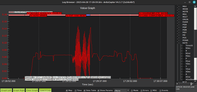

new 10 Inch quad set up using Methodic Configurator.
Initial tuning in Stabilise went OK , had to drop Pitch and roll PID’s by 50% as per the wiki to stop oscillations.
I have tried lowering PSC_VELZ_P by 50%, PSC_POSZ_P is already at 1 ( apparent minimum )
bin log : 2025-04-28 17-28-59-anon.log - Google Drive
Any pointers on where to go from here ?
Set the Hover thrust parameter to .06 and set these accordingly:
PSC_ACCZ_I,0.12
PSC_ACCZ_P,0.06

@dkemxr I tried those values, and that sees to have done the trick. Please enlighten me how you got to those values ?
It’s just one step in the process but an early one. Detailed here Initial Tuning Flight
