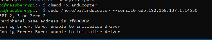

I did step by step as instructed. and when i run the command :
  • sudo /home/pi/ardupilot/build/obal/bin/arduplane -A udp:192.168.137.1:14550
i get this error :

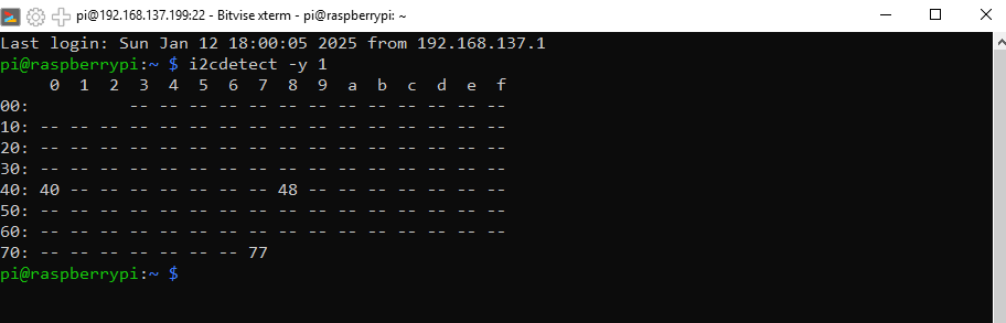

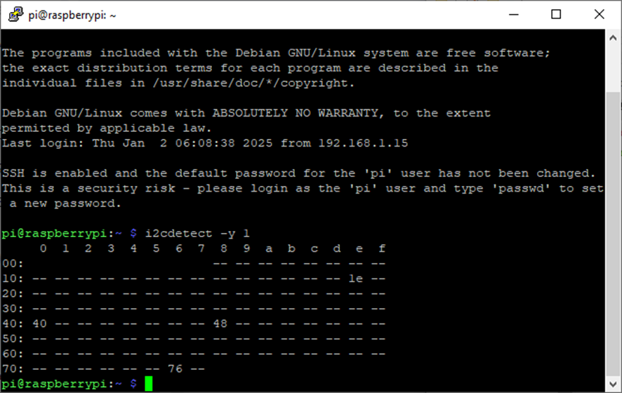

I try running i2c test “i2cdetect -y 1” and get this
Is there any way to fix this error?

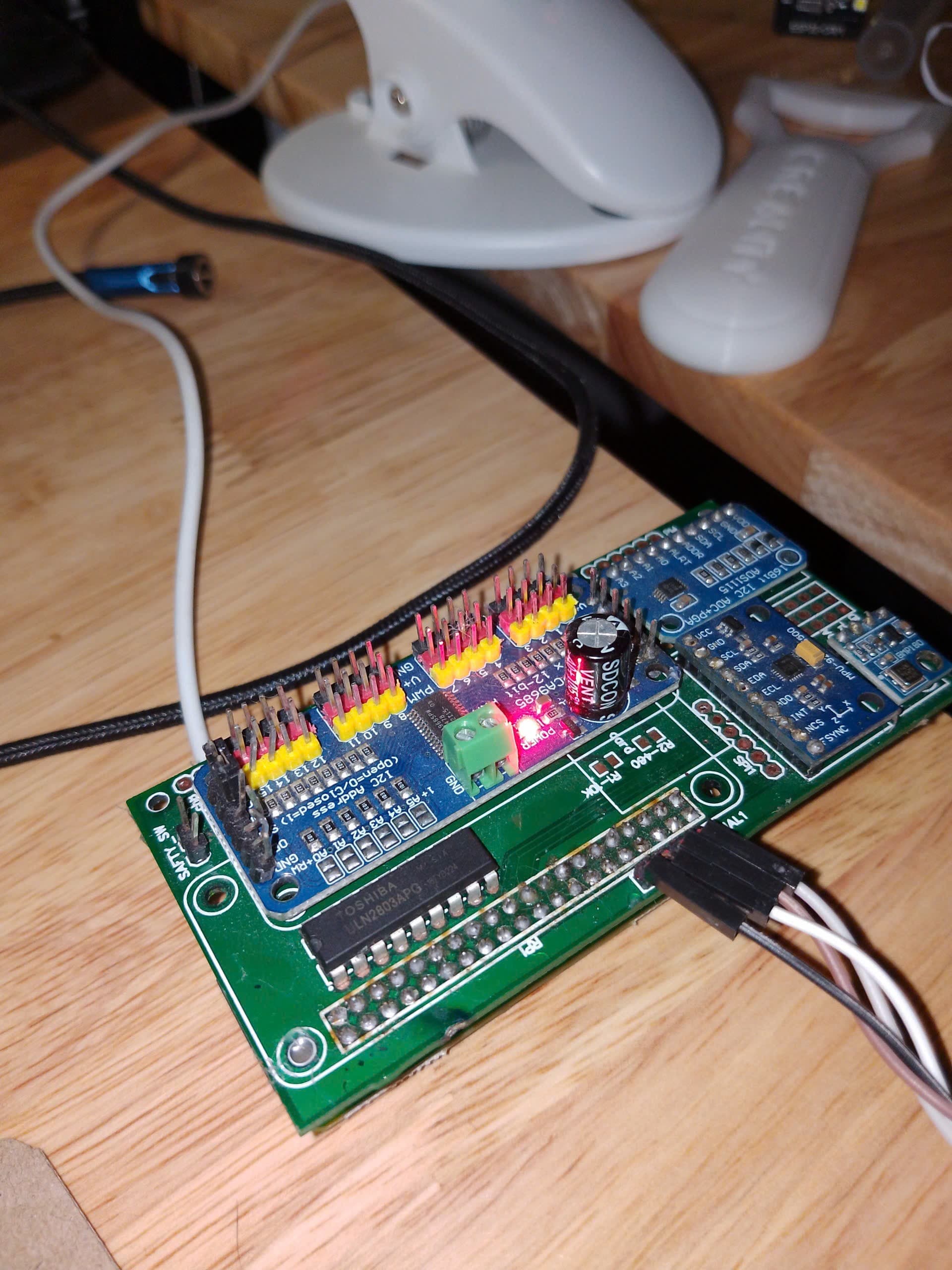

This is the circuit board that i followed the instructions

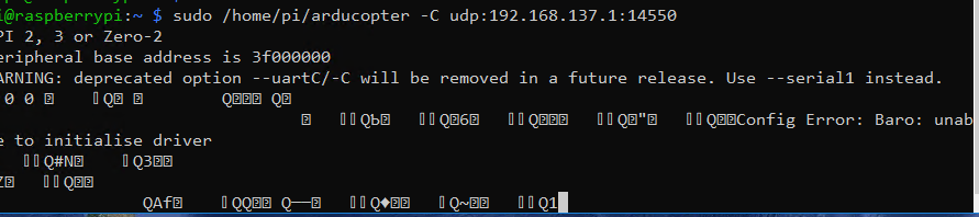

When I change the command line, the screen display is different “sudo /home/pi/arduplane1 -C udp:192.168.137.1:14550”
but now Mission Planner is not connecting to Raspberry pi

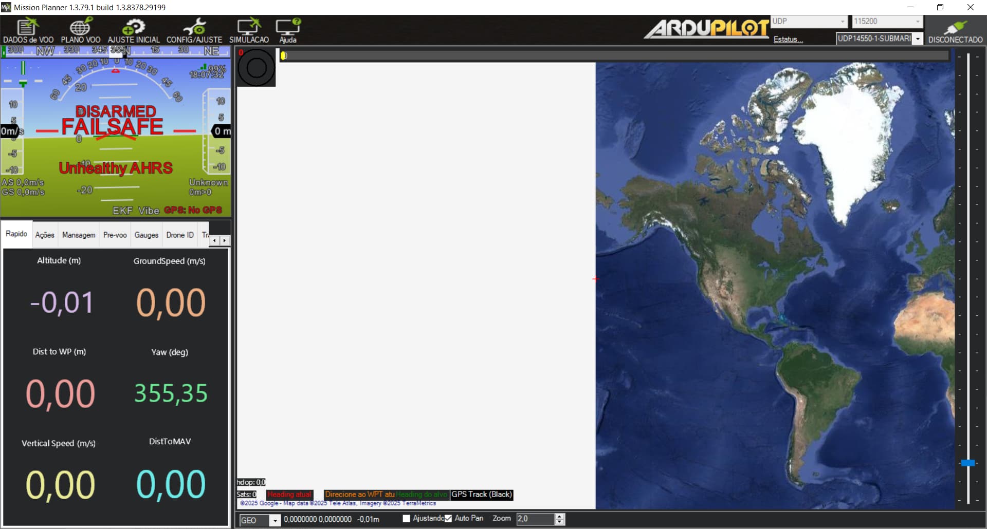

Hello, I am a beginner and I’m having some difficulties. I am using a Raspberry Pi 4 (Linux raspberrypi 6.6.69-v8+ 1 SMP PREEMPT Sat Jan 4 21:36:40 -03 2025 aarch64 GNU/Linux) and I have modified the kernel (like this: Running Ardupilot on Raspberry OS-64 (bullseye) | by Mohammad Hefny | Medium). I built the code following the instructions from this guide:
git clone GitHub - ArduPilot/ardupilot: ArduPlane, ArduCopter, ArduRover, ArduSub source
cd ardupilot
git submodule update --init --recursive
make obal
./waf configure --toolchain=/opt/cross-pi-gcc/bin/arm-linux-gnueabihf --board obal
./waf sub
nano /home/pi/ardupilot.parm
SYSID_THISMAV 1
FRAME_CLASS 2
FRAME_TYPE 0

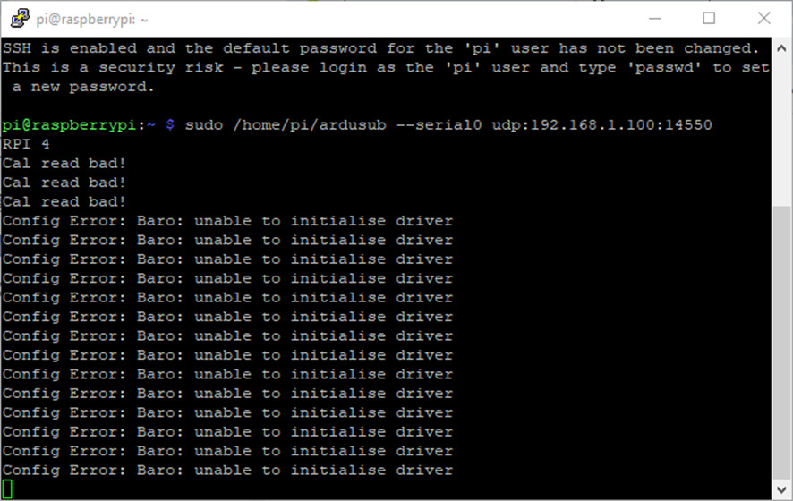

sudo /home/pi/ardusub --serial0 udp:192.168.1.15:14550
The Mission Planner establishes communication but does not receive sensor data.
Which Baro do you use?

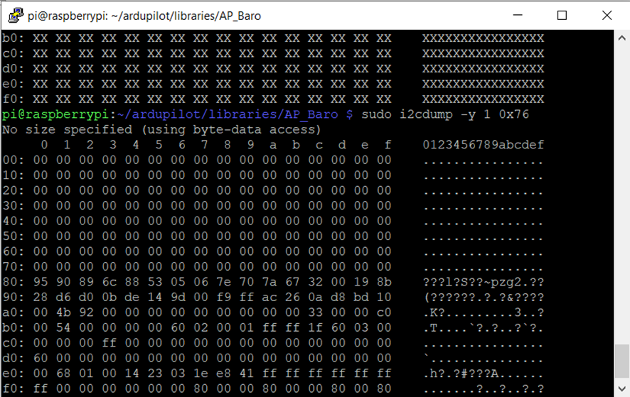

First of all, thank you for your prompt response. Initially, I was using a sensor I had purchased as a BMP280. After asking, I continued testing and discovered that it was detected at the address 0x76 0xD0 0x60, which means it’s actually a BME280, and perhaps that’s why it didn’t work.
After that, I tried a sensor I use with the Pixhawk, the MS5837, but it also didn’t work initially. However, when I tried again to respond to your question, it finally started working. Most likely, the first time I tried, I connected the sensor to the same bus as the BME280 with the same address, which must have caused a conflict. Now, after disconnecting the first sensor, it’s working perfectly!
I feel a bit embarrassed because I had tried extensively before asking, but at the same time, I’m very happy that it’s now working.

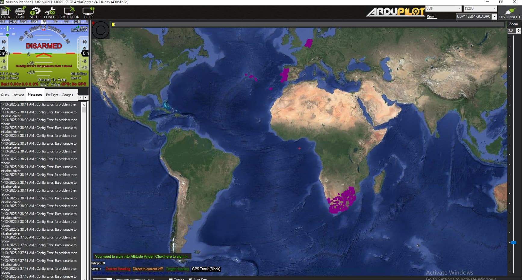

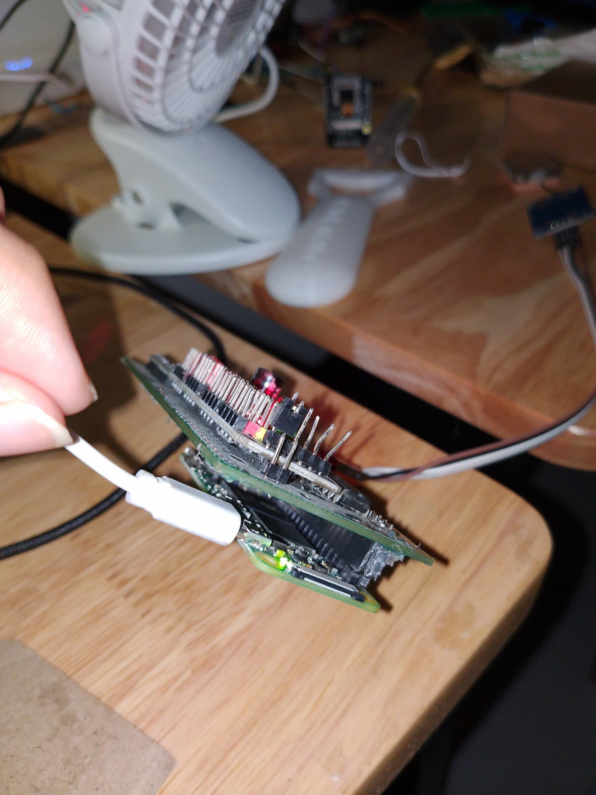

hi, did you find the reason why Mission Planner can’t connect OBAL board? I am also having the same problem. The baro sensor I use is BMP180. I tried all the parameters but still can’t make it work can you share your experience with me
Which Baro did you use and how you connect it?

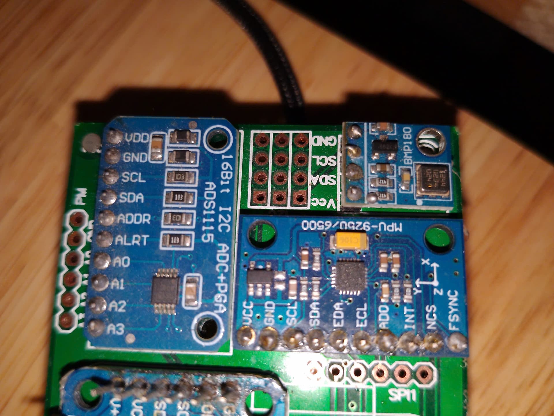

i use Baro BMP180 And this is my board

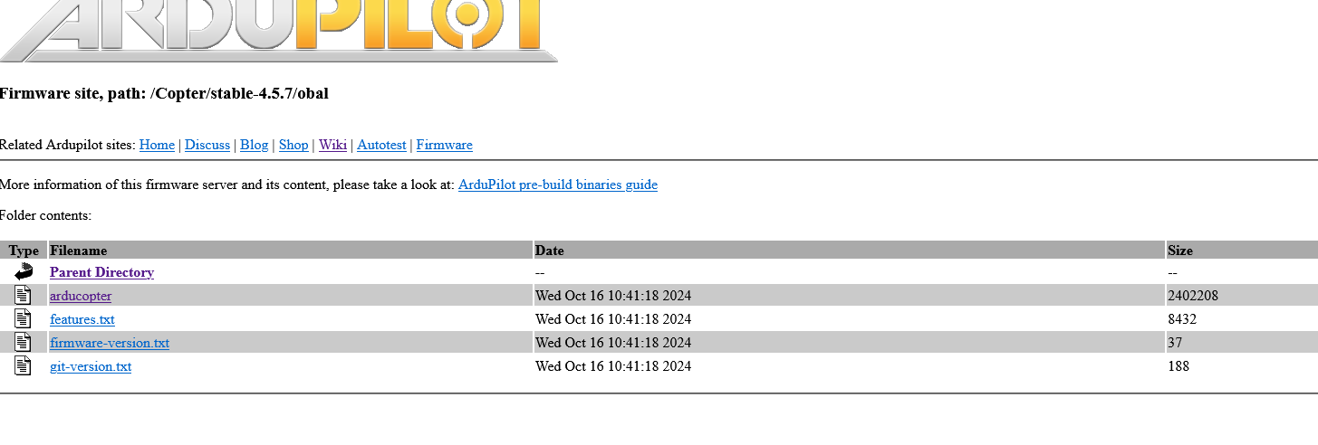

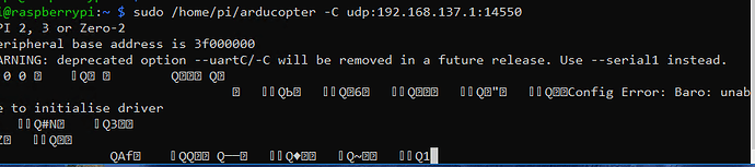

i downloaded the latest version of Arducopter

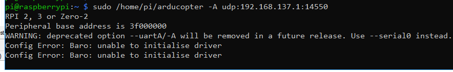

i downloaded the latest version of Arducopter. and here are the commands i ran on Raspberry pi Zero 2 W
sudo /home/pi/arducopter --serial0 udp:192.168.137.1:14550
sudo /home/pi/arducopter -A udp:192.168.137.1:14550

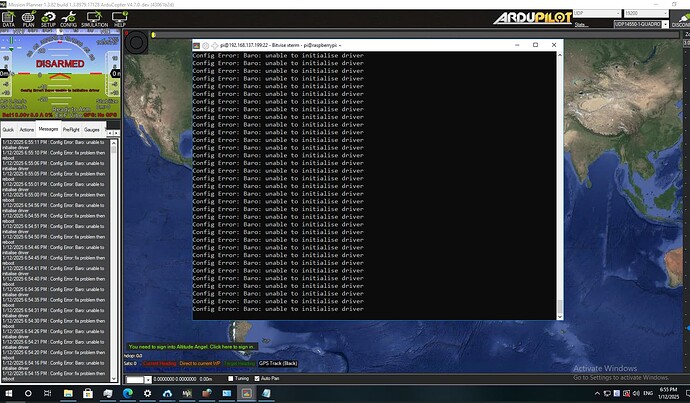

i tried recompiling OBAL but the result is the same
the above commands when run can connect to Mission Planner
but if I change the parameter -A to -C
the result is like this
I used to run Ardupilot well and successfully connect to Mission Planner on this board built a few months ago. But then I temporarily put aside the work of testing this board.
Now I go back, do exactly what I did and I have this problem again.
I tried running the command i2cdetect -y 1
and found that the board recognizes the components
so I really don’t know where the problem is
I don’t know what exactly is the problem.
let’s start with easy tests. can you try this library : GitHub - m-rtijn/bmp180: A Python module to handle the I2C communication between a Raspberry Pi and a BMP180
it shall try to access the Baro and see if it really works.
