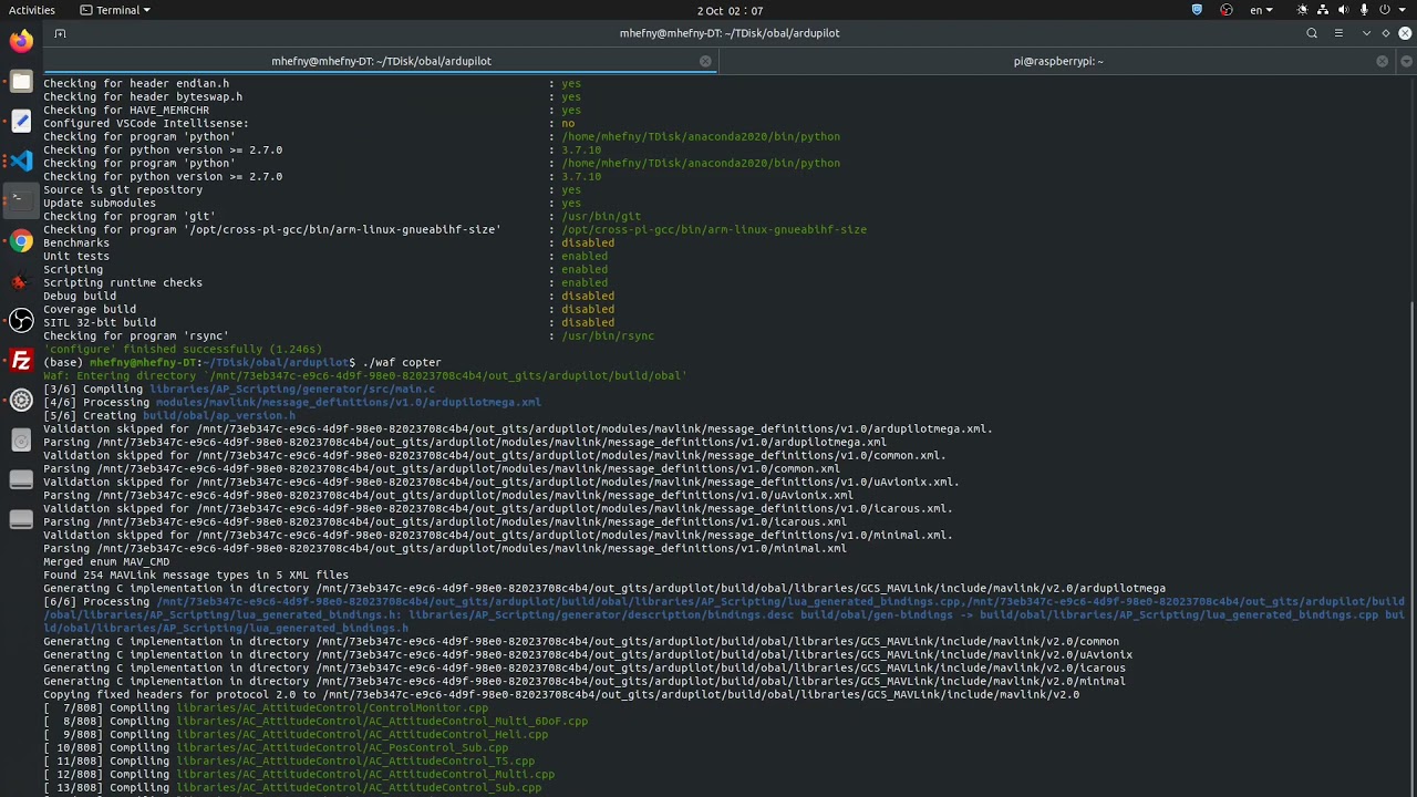

Hi, can I install and compile Ardupilot completely on Raspberry pi Zero W without using a second computer?
I’m using windows 10 and don’t really have much programming skills.
I followed the instructions from here: https://github.com/HefnySco/OBAL/blob/main/SourceCode.md
I get an error like this while running the command : “make obal”
What should I do next?
And I not really understand this
“For Raspberry-Zero you can download its cross-tool from here”
Does this mean that I will have to download “Raspberry Pi GCC Toolchains Files” to the memory card of the Raspberry Pi Zero W?
Sorry for asking too many questions, I’m just a newbie and don’t have any experience with programming, but I’m very curious to learn about Ardupilot and OBAL Broad
Do you have a group chat on Discord, Telegram or something … I really want to know more and can learn from you faster
No module named 'future'
You need to install this python module.
pip3 install future
For RPI-Zero you need to install another compiler.
then to make the board you need.
./waf clean
./waf configure --toolchain=/opt/cross-pi-gcc/bin/arm-linux-gnueabihf --board obal
./waf copter
the above path “/opt/cross-pi-gcc/bin/arm-linux-gnueabihf” is for Linux and you need to replace it with your Window’s path of the compiler.
Another option is that you compile the code directly on your RPI-Zero.
Finally I can compile it and send it to you :slight_smile:
