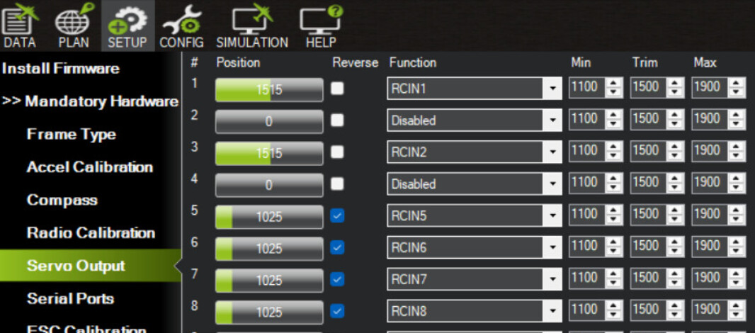

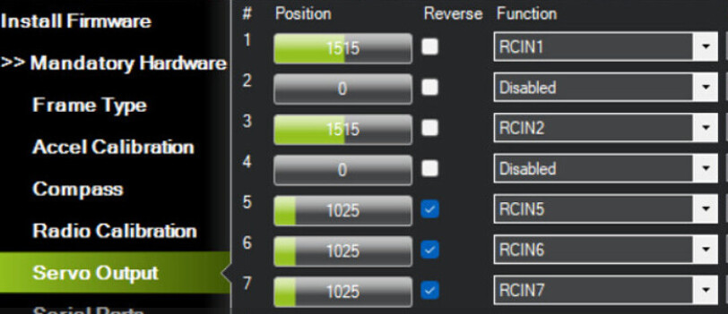

No output using ThrottleRight and ThrottleLeft, but RC passthrough works
Equipment:
Orange Cube+
SmartDrive DC Motor Driver MDDS30
Flysky FS-i6X 10CH Radio Transmitter and Receiver FS-iA10B
Problem is that I can only get the motor driver to move the motors by using RCIN for Servo Outputs. Putting the ThrottleLeft and ThrottleRight in the Servo Outputs would not work.
Please help me with the Mission Planner Settings to get ThrottleLeft and ThrottleRight to work.
Arm the autopilot before attempting throttle output.
Thanks Yuri. After some troubleshooting, I got everything to allow Mission Planner to Arm and I did get the motors to run. But now the left motor only runs backward with the remote throttle ~ch3, and the right motor runs in both directions from the right remote stick ~ch1. How do I now get both motors to run off the right remote stick forward / backward / R&L turns? What else do I need to check or change to consolidate both motors to run on the right joystick?

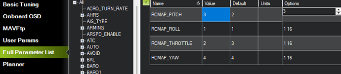

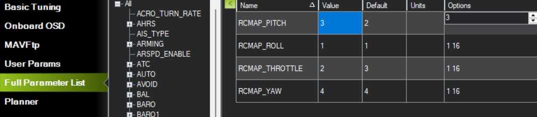

Use the RCMAP parameters to swap the channels around. Roll and Throttle are the ones you will be using for steering and throttle.
I tried the Scr Prt below but it didn’t work.
EDIT: try rebooting between changes of the RCMAP parameters.
And if you haven’t PROPERLY calibrated your radio in Mission Planner, then it’s all a moot point.
I recalibrated the radio several times with all centered except the Throttle being down. My project is a Rover and as a newbee I don’t know the airplane lingo.
My radio has the channels 1&2 being the Right Stick (both centered) and channels 3&4 being on the left (ch4 centered & ch3 Throttle) Given that what should I change to effect the Aileron and Throttle?
You were correct to swap the pitch and throttle channels.
