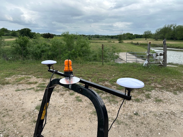

GNSS planning.
Choose a good satellites day and hour for your location, specially looking for low HDOP, and operate in open sky.
Use some u-box utility.
Any transmitters near the GPS antenna can cause interference.
Keep the GPS antenna away from all other antennas!
I have my 915mhz in between my 2 gps antennas. What do you mean by “near”?
For most of the drones around here we’re happy if we can get 10 cm. Looking at your photo I think you’ll be fine. :grinning_face_with_smiling_eyes:
@Allister If that 915MHz transmitter uses high power and has not output filter, it will cause issues, even at that distance
@marblecreek disable the 915Mhz transmitter and re-test. Does the problem go away?
