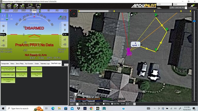

I took some time off and try again with clear head. Rover is 6-wheel thumper. Ardurover4.4.0-beta7. Motors are configured so no reversals are needed in MP. However throttle servo is reversed in the RC transmitter otherwise fwd stick = backwards motion. Driving good in MAN. Had to adjust MAX_SERVO and MIN_SERVO to track straight. Drives good in ACRO with similar behavior as MAN. When I switch to AUTO the line to WP1 is correctly shown on MP. L1 controller parms are greyed out (I assume due to > 4.2). The S-curve parms are set to
I know you want logs but if I connect via USB I get getlogentrytimeout. If I connect via telemetry I get a list of files but to download any of them is impractical as it would take hours for just one. I apologise but I just cant download these logs.
The problem is that when the vehicle is pointed directly at WP1. Moving it in acro back and forth shows the heading to be pretty much lined up and the left and right servo values moving together. BUT when I put in AUTO left servo goes full reverse and right servo goes full fwd. They should both have gone full fwd to go towards WP1. I thought that if ACRO works then motor configuration is correct to for AUTO. It will also not do CIRCLE mode correctly. How to test and fix ? Any help appreciated.
The after AUTO note the rover starts to turns away
