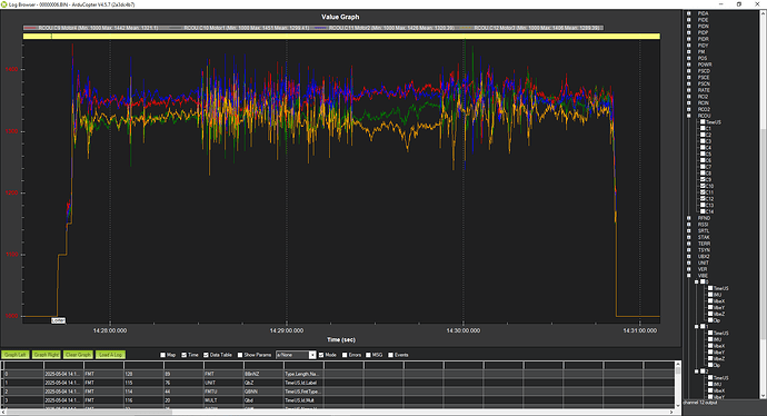

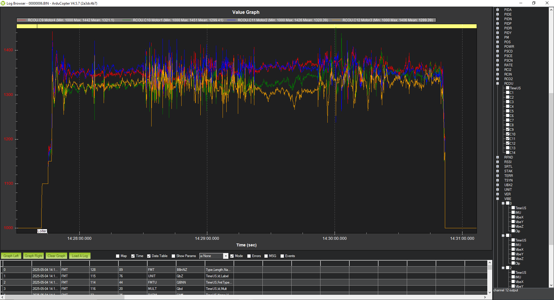

Upon checking the logs, specifically the RCOU section (motors C9 to C12), I noticed that the rear motors are working harder than the front motors. However, I don’t think this explains everything.

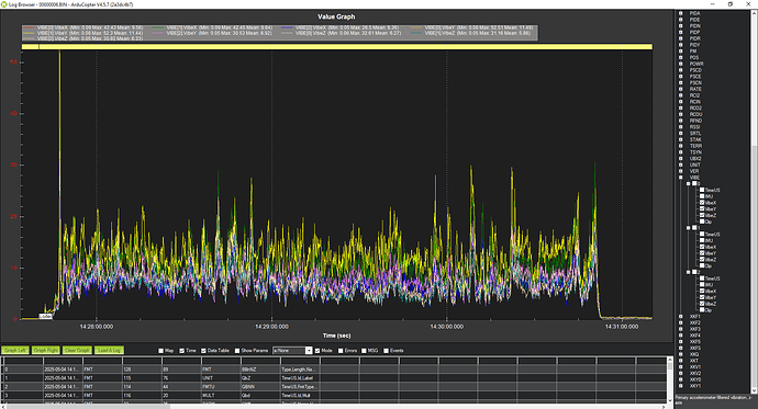

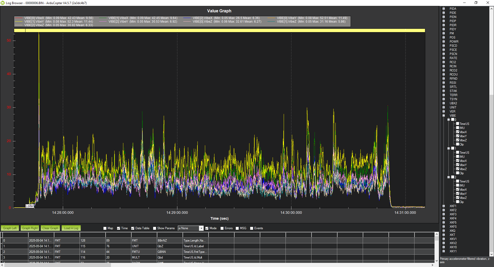

The vibration can also be seen in the image below:

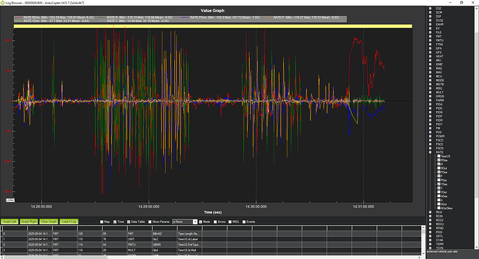

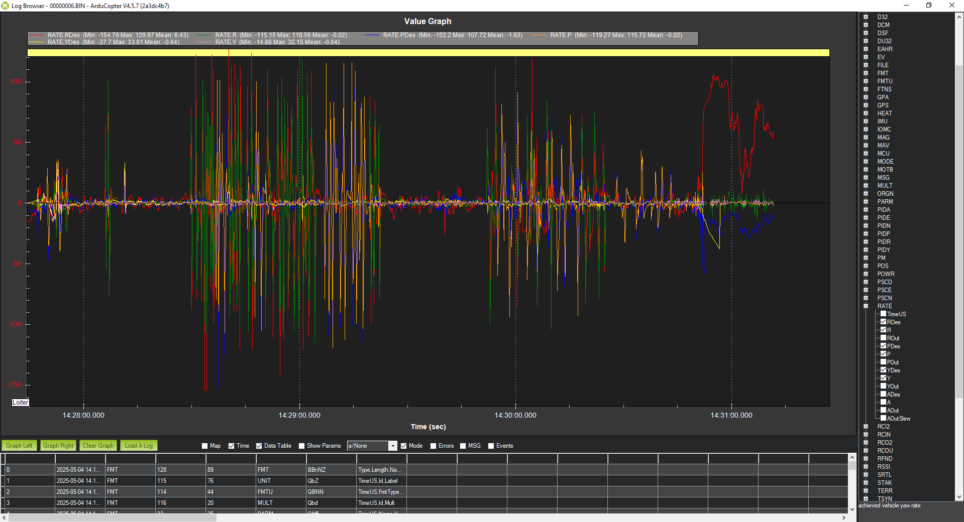

Also can see Rates below:

But man, those vibe levels are really high even realizing they are from flight dynamics. You have Dshot configured but no telemetry. Can you flash the Bdshot version of firmware and configure for that and configure the notch filter to use it?
