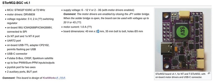

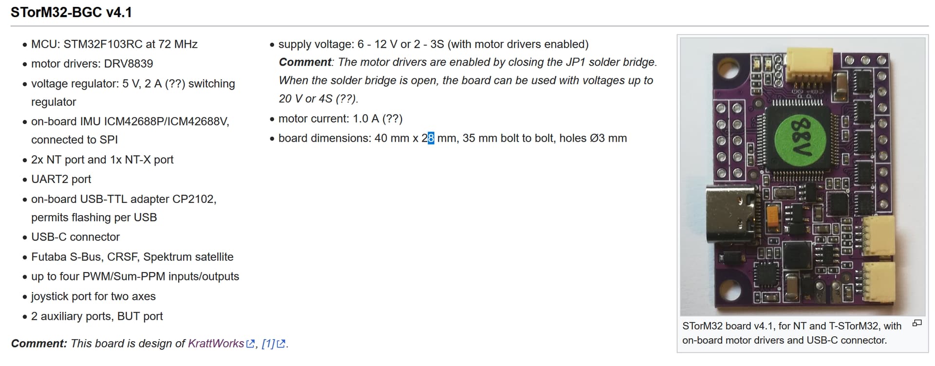

https://www.olliw.eu/storm32bgc-wiki/STorM32_Boards#STorM32-BGC_v4.1

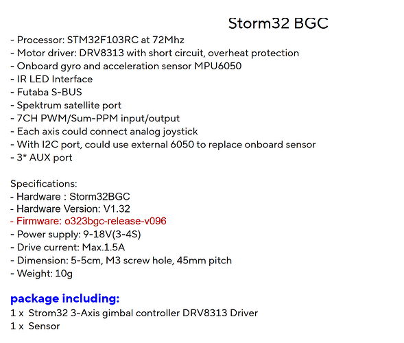

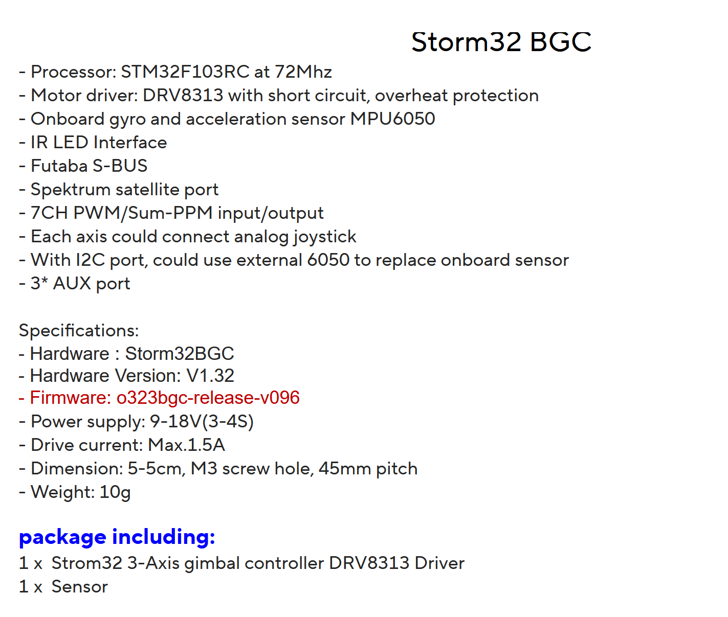

yes, but you can’t bay it anymore. only V1.3 with 0.9 Firmware
Yeah, I hope there’s some update info for us. And I think it’s worth getting the latest STorM32-BGC v4.1???

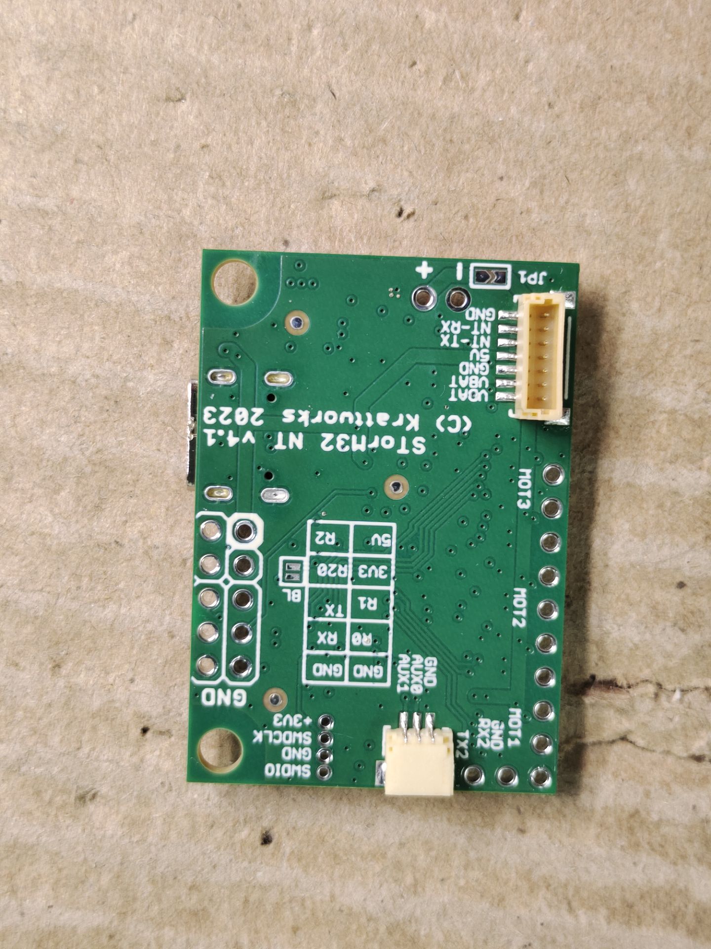

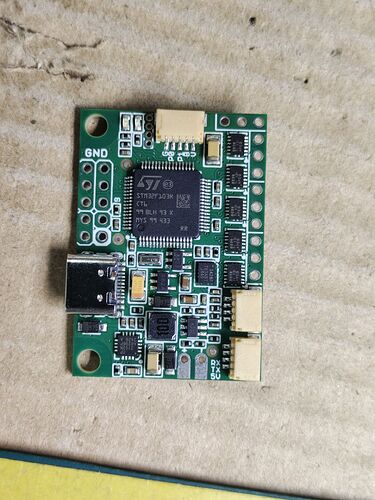

I’m actually getting it produced by PCBWay right now. I think it will arrive next week. I’ll share here if it’s working properly or not. If that’s the case, I can send you one of 5

Hi @andrewalson and @geunhee, sorry for late reply. I just received the board and uploaded firmware successfully! One last step is left which is the IMU connection, once I finally resolve that I’ll share my experience here.
@andrewalson Of course you can have one, I’ve 3 extra, no purchase needed just send me the delivery address in DM
I got the gimbal up and running with v4.1 board! and I have to say what an upgrade from v1.3!
