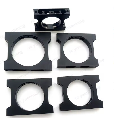

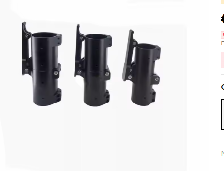

@xfacta what materials you would recommend for this monster? what arm mounts ? Show me atleast photo, i would find everything, lets start from begining. I’m in.
RJX Hobby has a lot of useful parts. You might be able to order from them, or there might be another supplier somewhere closer to you. They have many arm mounts, CF plate and all manner of fittings. Arm tubes can be ordered in nearly any size with different wall thickness.
so it would be better? mine arms is welded in the center. made x by aluminium.

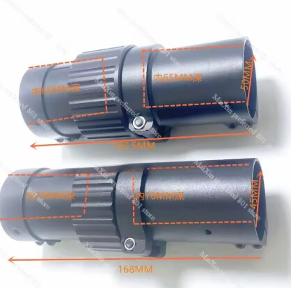

witch better these or these type?
this in mid arm.
and I using these to make it stiffer
@xfacta I will check it out, and maybe you could draw how it should look like, or atleast some examples, because you saw my frame, and i wondering how i could make it instead of aluminium to carbon fiber. what would be best, because i dont wanna make mistake and then go outside for another half years haha

I’ve never seen a large copter with so much aluminium before, unsure how that would go. It could depend on the grade of aluminium or how much strengthening they’ve done. All that guess work is avoidable by using carbon fibre.
The large copters I’ve worked with are still two CF plates with high quality 3D prints for the body in between, and high quality machined aluminium arm mounts. Also some “stand-offs” linking the two CF plates together somewhere in the middle.

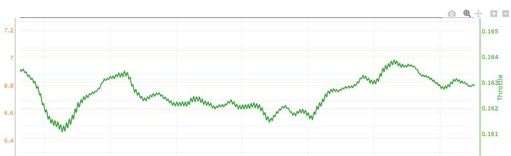

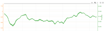

There is a small oscillations in vertical controller, lowering PSC_ACCZ_P/I might help or maybe adding a little of D. Try PSC_ACCZ_D like 0.005 or so.
and thats it? because now I always waiting for you guys to make tunning, and now i dont really know what to do, wait for you or just tune by my self?
What exactly you don’t like in current tune and how it affect flying?
Motors vibrating, that’s my only issue, sure, we didn’t tried full weight on him. So main problem impulsive motor vibrations.
