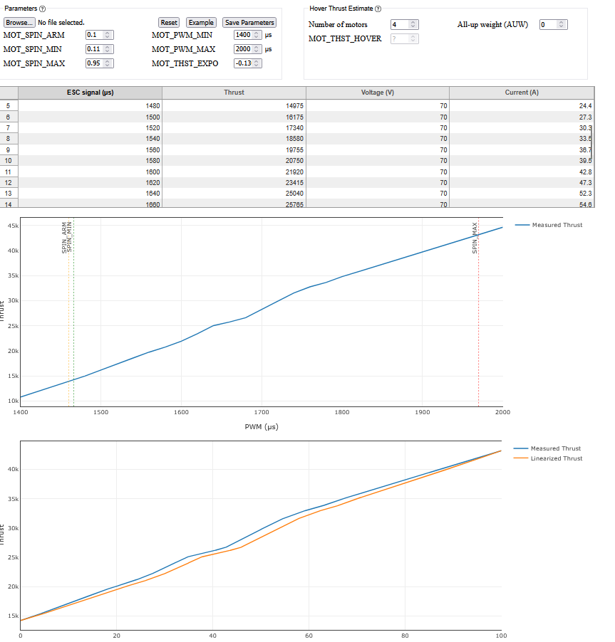

not sure about MOT_THST_EXPO on this motors, some of hobbywing comes already linearised, maybe someone more experienced can clear this,
if I use datasheet provided reference I get something like this

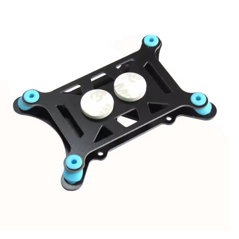

BTW-How is the Flight Controller mounted?
But still how about arms? They still shaking a lot. I willl try tomorow and i will post instantly. My FC mounted like this. I will try to swap settings but the higher D the more shaking in arms.
I would get rid of that and “hard” mount it to the frame.
