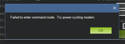

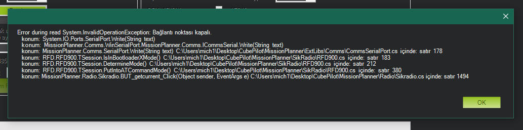

Errors Encountered When Trying to Access SiK Radio Settings (Main Obstacle): When I connect the ground telemetry module to my PC via USB and try to access the SiK Radio tab (e.g., by clicking “Load Settings”), I consistently get the following errors:
  1. Error 1: “Error during read System.InvalidOperationException: Bağlantı noktası kapalı.(
  2. Error 2 (Sometimes get this one instead):Failed to enter command mode. Try power-cycling modem.(
These errors prevent me from accessing the radio settings in the SiK Radio tab, so I cannot check or match the Net ID or other parameters.
