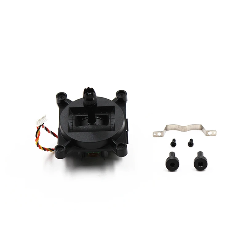

Hi, is there anyone here with a T12 that they are willing to sell? I’m in canada, and one of my gimbals is defective, and I don’t know how to get one from Skydroid.
It reads only three PPM numbers - when the stick is low, it reads 1000. When the stick is medium it reads about 1600. When the stick is high it reads about 1900. But it does not read anything between those numbers.
I did not know if the problem was hardware or software, so I exchanged the two gimbals. The problem follows the gimbal, so the problem must be hardware, not software and not calibration.
I understand how to put it into calibration mode (turn on with C and D held down, then long press C, move both gimbals, long press C again, then power off). This does not fix it.
Contact HeliEngadin.com, they ship internationally.
https://www.heliengadin.com/products/skydroid-t12-remote-controller-with-digital-video
Your problem could be dirt on the cardan. Without connecting the Skydroid you should introduce alcohol into the defective potentiometer and move the cardan up and down several times, then wait for the alcohol to evaporate. could be the solution. by trying you don’t lose anything

Hello Ivan. So solved it? I have the same problem. Maybe it be to place an ather one bracket?
daa43c9e92a827ca940b20efe24ffe51fde06364_2_372x500 I need to make it proper Mode 2 with the stick down,not in the middle,but the stick return up (i remove allready the spring). So where sould i found an ather one bracket to add? Is any other solution?
Ordered, Thanks so much PAPO :raised_hands:
Gal
I’m looking for this particular part to add it as a second to avoid stick return. I do not want to order the hall gimbal. Is any other mod I can do?
You have to remove the upper rubber for moisture protection. It also looks like the photo, without rubber
I didn’t know that is removable. I will do that. Thank you PAPO!!!
It is.
just a little hard to remove
