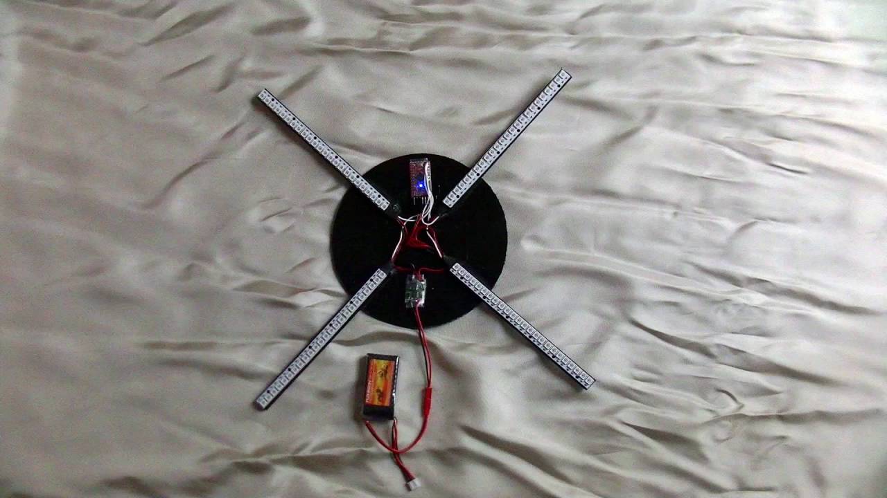

Hi I was recently in China…at night there was some kind of copter flying that had flashing lights… it was
almost like fireworks. Is this something available or is it something that has to be built. i woudl like to get an inexpensive model of this if possible… I am not a builder, nor knowledgable about drones/copters.
What do you advise?
JBC
To my knowledge… No premade (buy-and-fly) packages. (And what’s the fun in that ???)
This is how I did it:
  1. Make/Buy a DJI F450. ($200-$300 kit/premade) or spend under $100 for the parts and make yourself.
  2. Learn to fly it… Be aware, this doesn’t come easy, YOU WILL CRASH… a bunch. (i.e. need extra parts.)
  3. Learn to wire & program microcontrollers. I prefer Arduino. At $2 each, they can’t be beat.
  4. Learn to wire & control WS2812 5050 RGB LED Lamp Panels with the Arduino.
  5. Build a frame to hold 12 of the above panels under the DJI F450.
  6. Perfect the APM flight “Autonomous” (Auto) flight mode, with low-voltage RTL and RTL fail safes. (To be safe flying in complete darkness.)
This is what I finished putting under my F450 drone. It casts shadows on the ground from 200’ up.
The last pattern in the video may be what you’re talking about.
