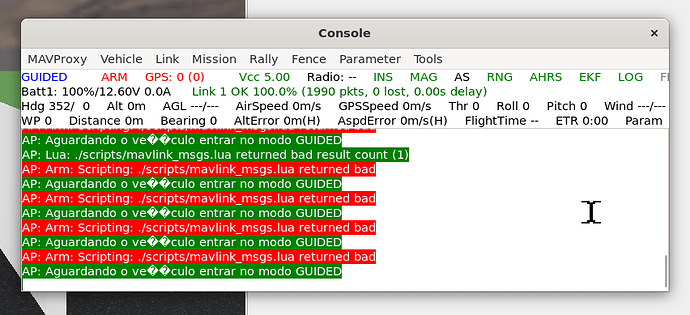

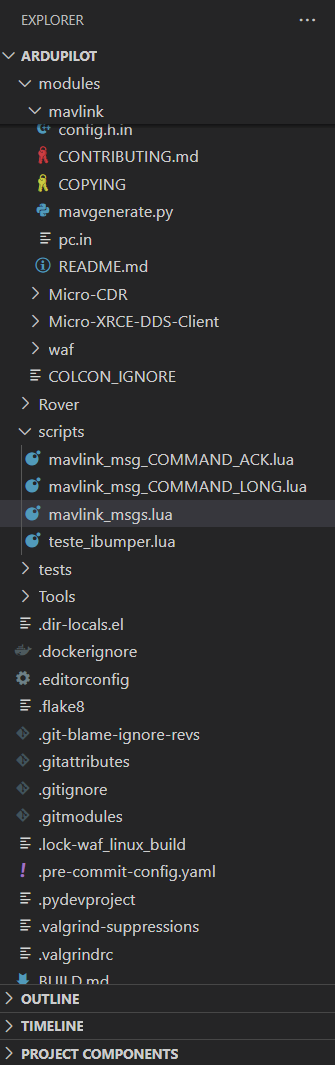

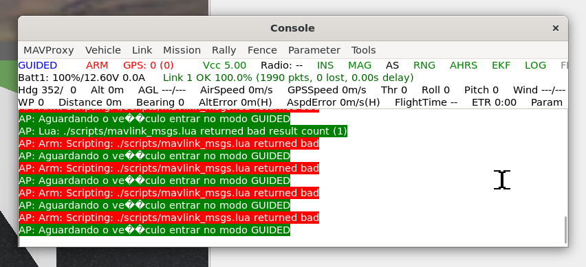

Hello @snktshrma, hope you doing great!
So, i’ve tried to run one script that i try to send a MAVLink command through lua, but i’ve got following error.
Could you help me understand why this error occurred? I added the required scripts on the path you gave me to my scripts folder, and then this error appeared.
Thanks in advance!
Hi @gsouza !
So the folder structure should be like this:
scripts/
β”œβ”€β”€ modules
β”‚ β”œβ”€β”€ MAVLink
β”‚ β”‚ β”œβ”€β”€ mavlink_msg_COMMAND_ACK.lua
β”‚ β”‚ β”œβ”€β”€ mavlink_msg_COMMAND_LONG.lua
β”‚ β”‚ β”œβ”€β”€ mavlink_msg_FOLLOW_TARGET.lua
β”‚ β”‚ β”œβ”€β”€ mavlink_msg_GLOBAL_POSITION_INT.lua
β”‚ β”‚ β”œβ”€β”€ mavlink_msg_HEARTBEAT.lua
β”‚ β”‚ β”œβ”€β”€ mavlink_msg_SERIAL_CONTROL.lua
β”‚ β”‚ β”œβ”€β”€ mavlink_msgs.lua
β”‚ β”‚ └── Readme.md
β”‚ β”œβ”€β”€ mavport.lua
β”‚ └── NMEA_2000.lua
β”œβ”€β”€ test.lua
You have to copy β€˜modules’ folder into your scripts folder. That’ll solve the issue.
Let me know if you’ll face any issue
