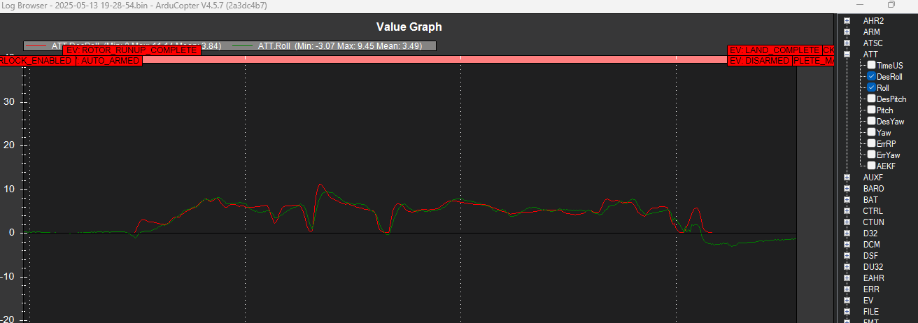

I hate to show my ignorance, but I do not know which parameters to view to determine this as instructed in the hover trim section, “noting the roll angle and pitch angle that you had to hold with the stick to keep the helicopter from drifting.”?
Do I look at the ATT parameters as shown in this graph?
@bnsgeyer, I forgot to thank you for telling me to set the ATC_RAT_RLL_D gain to 0.0001. I did that and the roll shaking problem is gone and has not returned. At least not for the last three test flights, and my gut tells me it will not return. So thank you for your help.
So my next issue is still understanding which parameters to look at to find the pitch/roll value while holding the heli in a hover. Hopefully someone will straighten me out with that so I can move one to the other tuning steps.

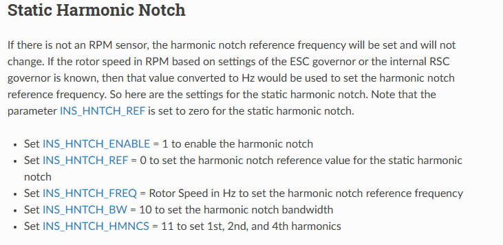

@Yuri_Rage, so I am trying to follow the documentation as you said, and when I get to the next section of notch filter setting I do not have the parameters that are listed in this section.
So how am I suppossed to set up filtering? I am using version 4.5.7.
Thank you.
Edit: I only have the INS_HNTCH_ENABLE parameter. None of the rest are listed.
Enable it. Refresh. The rest will appear after enabling.

yes, you would use the roll and pitch signals from the ATT message. Looks like Yuri already commented on the Notch filter. Let us know if you have other questions.

@Yuri_Rage, oh man I feel dumb now. I thought I had written the params, but I obviously did not because now I got a message about the new params being loaded. Thank you for your help, and not laughing at me, Lol. :rofl:
@bnsgeyer Hi Bill. So looking at the ATT graph I posted, what would you say is the angle amount I should use to set the ATC_HOVR_ROL_TRM param? To me the red/green lines are too close to see a real difference.
Thank you.
It is not about the difference between the desired and actual roll angles. It is the steady roll angle that you are trying to judge. based on that plot, I would say the ATC_HOVR_ROL_TRIM should be set to 500. if your heli drift in the pitch axis then you will need to set the AHRS_TRIM_Y as I describe in the wiki.
@bnsgeyer, oh I see. I completely misunderstood how to do that. I set ATC_HOVR_ROL_TRIM to 400 based on what I saw while hovering and did a test flight. It was much better. I think I will try splitting the difference and set it at 450 and test again. I will eventually get this tuning figured out, and then stop asking so many questions.
