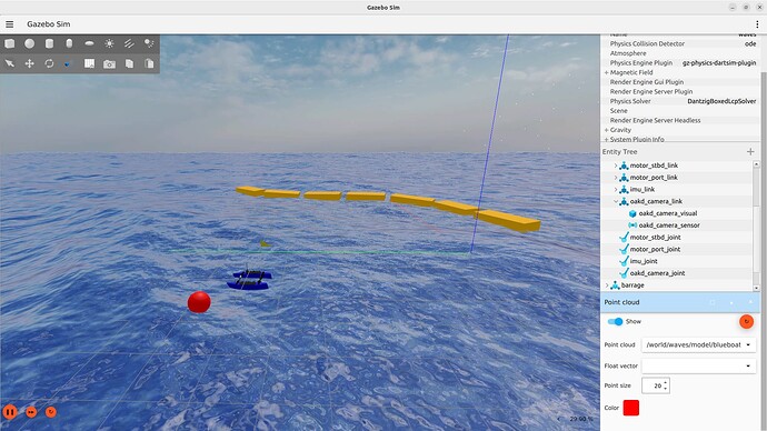

I’ve been developing a simulation environment using your waves.sdf as the world, where I placed a BlueBoat model equipped with an OAK-D stereo camera. The boat is controlled via the ArduPilot plugin.
However, I encountered an issue: although the point cloud topic is being published in Gazebo (confirmed via gz topic -l), I cannot visualize the point cloud in either Gazebo or RViz.
Key Observations:
  • The point cloud topic appears in Gazebo, and I can echo it, showing data is being published.
  • In RViz, the PointCloud2 panel shows: “0 points from 0 messages”, despite the topic being listed and echo showing outputs.
  • Gazebo’s interface also doesn’t display the point cloud from the OAK-D camera.

Hi @Andy_Chen, nice to see you’ve got the BlueBoat sim running. Most likely the issue is with the configuration of the ros_gz bridge. Reducing the resolution of the camera will help with performance.

@rhys I solved the issue by setting the Fixed Frame in RViz to the sensor’s frame:
blueboat/oakd_camera_link/oakd_camera_sensor
Format follows: /model/link/sensor .
Additionally, I had to manually set up a static transform from the camera link to the sensor frame using:
ros2 run tf2_ros static_transform_publisher 0 0 0 0 0 0 oakd_camera_link blueboat/oakd_camera_link/oakd_camera_sensor
The tricky part: when SDF is converted to URDF, the <sensor> tag gets dropped, and ROS doesn’t recognize the sensor frame by default. However, typing the exact frame name in RViz still works after adding the static transform. Not sure why, but it works.
@Andy_Chen if the TF from the model was generated correctly, that should not be necessary (except maybe a static TF from map to odom if that is not otherwise available). The iris with gimbal example in ardupilot_gz has all the necessary transforms to handle the additional elements attached to the vehicle.
I wonder if some of these are missing in your set up. Getting sdformat_urdf to work correctly on more complex models is a bit fiddly as there are some issues traversing nested models.
