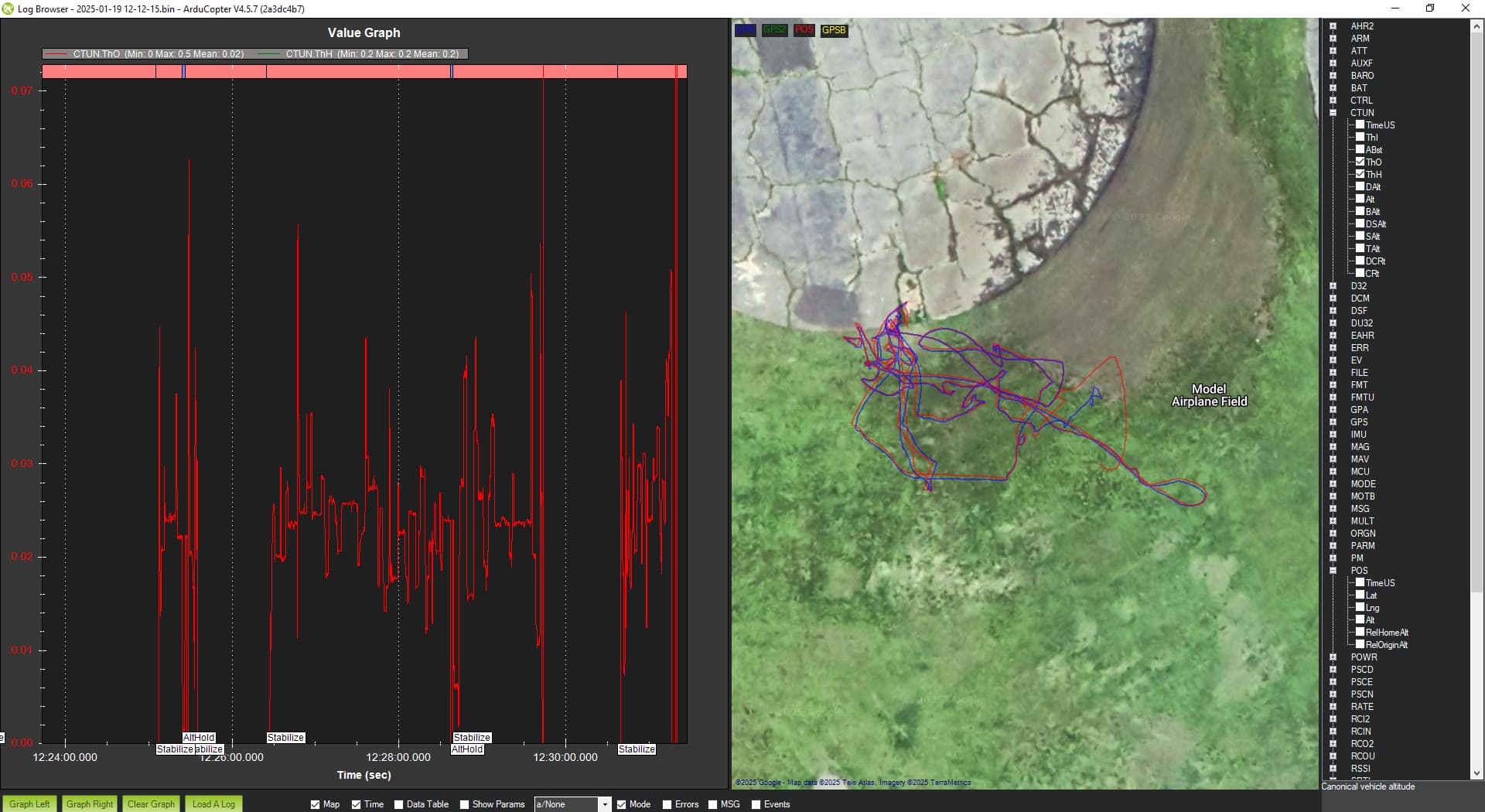

Review the log of that hover flight and graph CTUN>ThO (scaled throttle output) & ThH (calculated hover throttle) They should be close or converge if it’s learning. In fact this is a good way to set the hover throttle value.

I’m attaching a screenshot of one of my last logs, where I was able to manually maintain constant altitude (more or less) - I may be reading the graph incorrectly but it implies 0.022-0.024 is my hover throttle (which admittedly does not make much sense to me) - but CTUN.THO has a mean value of 0.02. I will read up on what the “scaled” part of scaled throttle value means.

Use Daves method of setting the hover thrust from reading the value from within a log, but also you may have to set MOTOR_HOVER_LEARN,0 so it doesnt change. Experiment with that to see what suits your copter.
