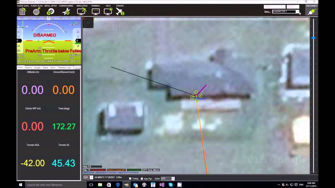

Thank you so much, this has been a great help to me. How is the temp window in the video opened?
Press “Ctrl-F” but I think that is no longer necessary, there is “Setup >> Optional Hardware >> RTK/GPS Inject”
Yes, I did see that page, but I’m curious if there are any additional settings needed on the UAV side, or if the RTK base will automatically sync to the UAV, because I plan to do some testing with the PC+RTK base set up on a trolley.
The GNSS receiver antenna from the RTK basestation must be stationary during the ArduCopter flight.
There are no aditional settings.
It can be mobile all you want, when the copter is not flying.
