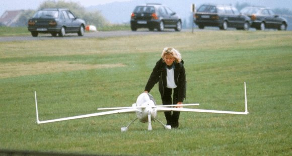

I have a large Verieze style carnard ready to fly but need to mix for the split rudders used on this kind of aircraft.
The rudders, located on the winglets operate outboard only and used singly for yaw control or can be deployed together as a speed break.
Model is a Rokemodell speed canard as below picture

However the rudders as designed by Burt Rutan operate separately out on the wingtips.
Left yaw left rudder moves, right yaw right rudder moves.
Am I confusing myself about this or can Arduplane achieve this behavior?
If you want to preserve that behavior, I believe you could configure Ardupilot to do it.
Let’s pretend that each rudder takes a value from [-100 to +100] where -100 is full-left, 0 is centered, and +100 is full-right.
Configure both channels to the servos as rudders. Configure your left rudder’s MAX limit to be 0. Configure your right rudder’s MIN limit to be 0.
If I understand correctly, this should produce the desired rudder behavior. Let us know if you want more details, or run into problems?

You will be doing a unique application as I understand only 1 winglet will move to give desired rudder control.
In that case, you will need to set your SERVOn_TRIM equal to the MAX or MIN depending on the direction your servo moves. This will cause the rudder to stay still while the opposite rudder is engaged. This is basically what @hunt0r is saying.
Example:
Servo 4 = Control surface
1100PWM = Control surface straight
1900PWM = Control surface deployed to induce yaw
Set the following:
SERVO4_Function = Rudder
SERVO4_MIN = 1100
SERVO4_MAX = 1900
SERVO4_TRIM = 1100 (or maybe 1101 if you get errors)
SERVO4_REVERSED = 0 or 1 so that when the closest aileron moves upward in FBWA, the rudder deploys.
