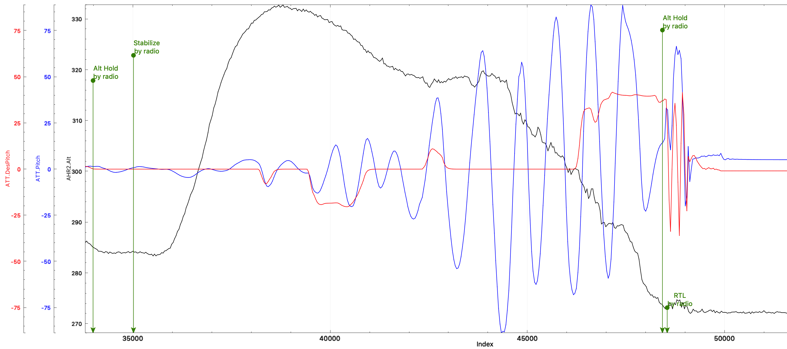

Hi Guys, I am looking for some help reviewing 2 logs from 2 separate crashes that recently happened with a larger hexacopter. My first crash was last week and at that time it seemed like the crash may have occurred from a flight controller mount coming slightly loose and introducing vibration. I rebuilt the hexa and again had a crash. Both crashes happened after the copter flew well for a perriod of time. I was able to perform a succesfull autotune both times and safetly land (the yaw was quite sloppy after the autotune) The next flight is when the crashes occure. Both times the hexa has a hard time keeping stable and starts pitching back and forth very aggresively until I can’t control it at all and it hits the ground.
This hexa only has about 40min of flight time on it so far.
It has a Black cube mounted in a KORE carrier board.
Has 15" props using T motor motors and Hoibbywing 40A ESC’s
I have another hexa that it setup almost identical except it is running an older pixhawk. I have been flying this one for over 2 years without an issue.
At this point I am at a loss as to what is happening.
I uploaded both crash logs to the link and also the log from my most recent autotune that did not have a crash. The next flight after it did. The most recent log is “Crash_2020-04-30 20-20-44”.

In the log for 2020-04-20 I see Roll and Desired Roll are almost always departed and eventually the flight controller cant maintain any stability. Pitch is not so bad, yaw is not ideal but not the cause of the problems.
There’s also some Z vibrations causing some clipping, but that’s mostly once the craft is already in trouble and almost beyond saving. Vibes are probably something to keep in mind for later.
Based on that log, I’d probably change these parameters at least:

In the next log, 2020-04-30, there’s other things I noticed that may or may not exist in the first log
There’s a slight weight imbalance to the left side - not a big problem but something to watch out for.
EDIT: for Kore carrier motor numbering, I think this will mean the FC is fighting a physical yaw problem not weight imbalance - a misalignment of motor mounts for example. It’s not drastic, although every little thing adds up…
Once again, Pitch and Roll depart from desired quite a lot.
Yaw and Desired Yaw are actually quite good in this log.
I see some PIDs are different to the first log, but some other parameters still look standard or strange.
I think all the previous recommendations stand, use that tuning guide and spreadsheet as starting points.
Z Vibes are definitely coming into play I think. All the usual apply, prop balance, loose items, wires knocking or pulling the flight controller or carrier board.

it seems you do have a tuning issue. The pitch gradually departs from the desired value until it got out of control during descending and crashed.
No signs of electrical issues.
it seems your troubles started with that loose mount, maybe the first autotune done while the mount was still onboard captured bad parameters and it keeps affecting your following flights?
as suggested by @xfacta I think a fresh start is the best course of action.
reinstall everything to default and use backup parameters from before the loose mount incident.
yah, crashing a large Hexa is a real pain…I wish you all the best next time!
by the way, in your next flight take baby steps and don’t attempt autotune till you have a good analysis of the first few flight logs. make sure this propagating error is no longer there.
