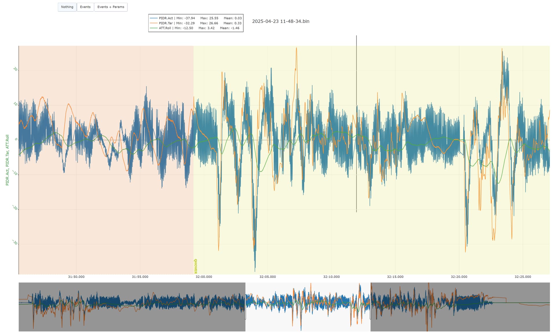

Hi, i am working on a big drone that have an H-frame. The drone is a vtol but i am posting this question in Ardcopter page since i am in hover phase testing. This is my first time working with DroneCAN protocole so I appreciate your guidance and support.

  • Do you have any comments about harmonic notch filtering setup?
  • Is it okay for you to take a look on these logs and give some insights about what mistakes I have? The drone is losing altitude immediatly whenever i command any attitude input.
  • I am trying to tune the drone but I never succeed achieving a better behavior. The drone is flyable and stable but not for auto missions.

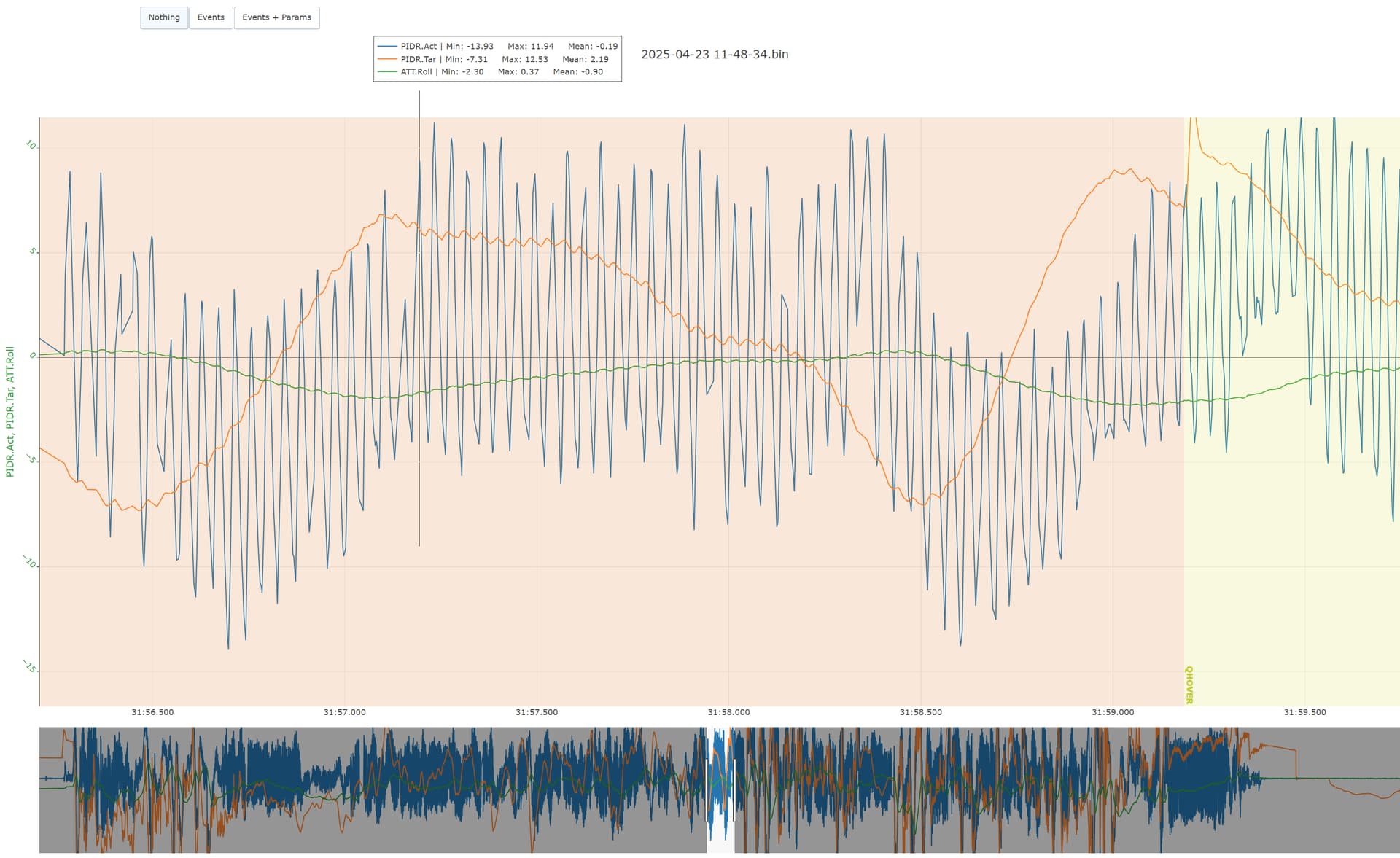

What i dont get for example, which also i have never seen before - such fluctuations
more zoomed

Check for motor output oscillation
what do you suggest to start with first?
I have no hot motor temp, also no hot escs. I am not sure of Audible vibrations/oscillations (honestly i dont know how can i test such thing for a big drone) and its not hard to control.
I can observe some shaking but cant tell if this is really the main issue.
Do you think lua script quick tuning for vtol would give me a better start?
The oscillations are very clear in the graph in blue. Start by reducing the roll PIDs.
