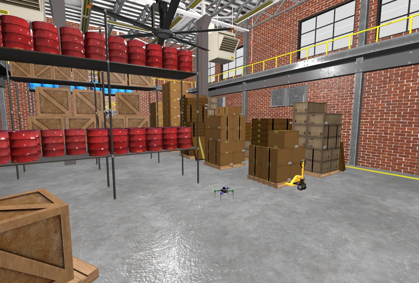

I began in simulation. Before attempting limited-FOV 3D-camera–to-map matching, I first tackled 3D LiDAR scan-to-map and incrementally raised the difficulty. The maze world’s repetitive geometry was challenging, so I transitioned to an industrial-warehouse environment to uncover the issues most relevant to real deployments.
To create 3D maps in simulation, I used KISS-SLAM. The main reason: it works out of the box without heavy setup for calibrations, extrinsics, or other details.

Simulation Result
Here’s the simulation result demonstrating robust translation and rotation accuracy even in empty/ featureless spots
Simulation Video

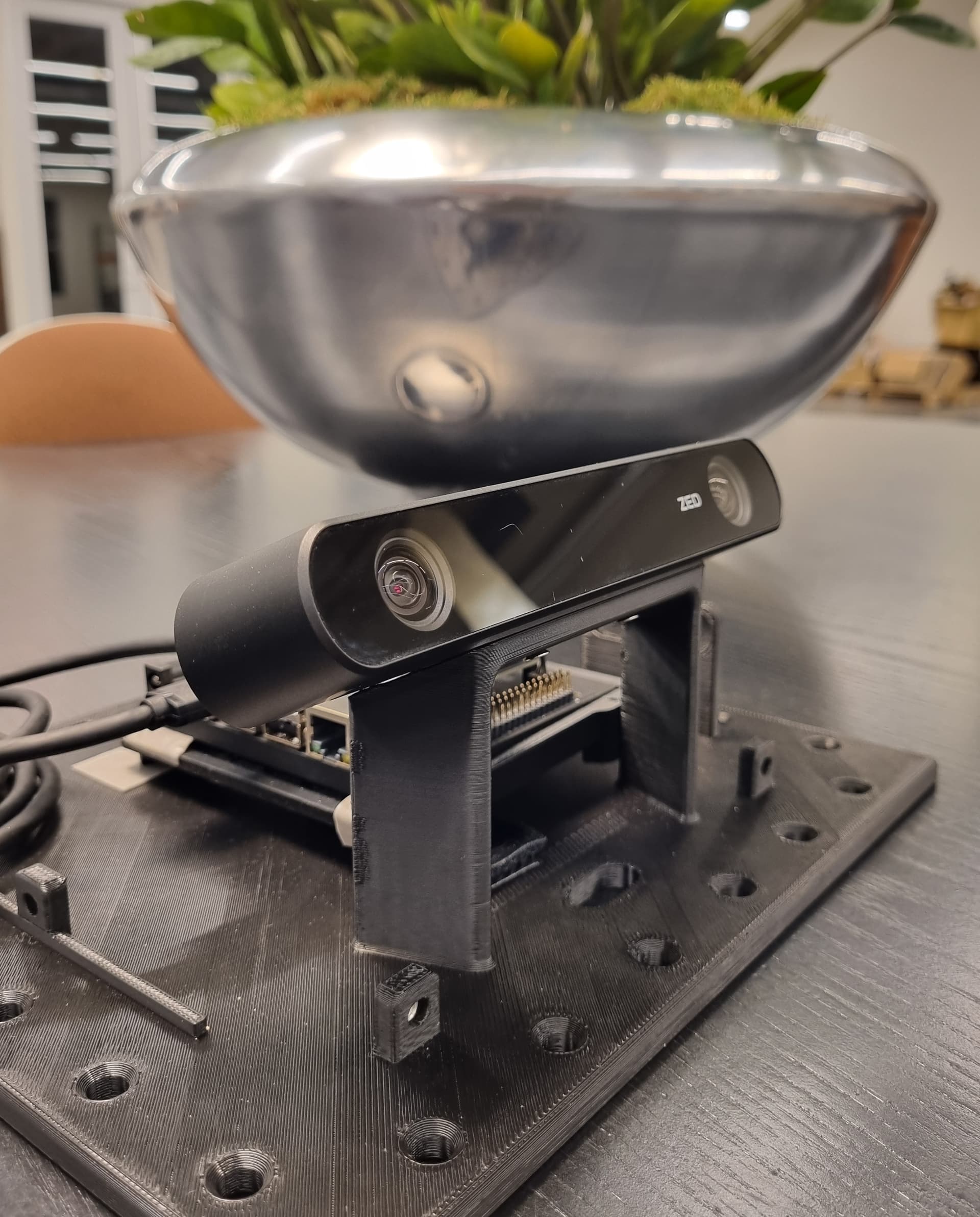

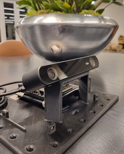

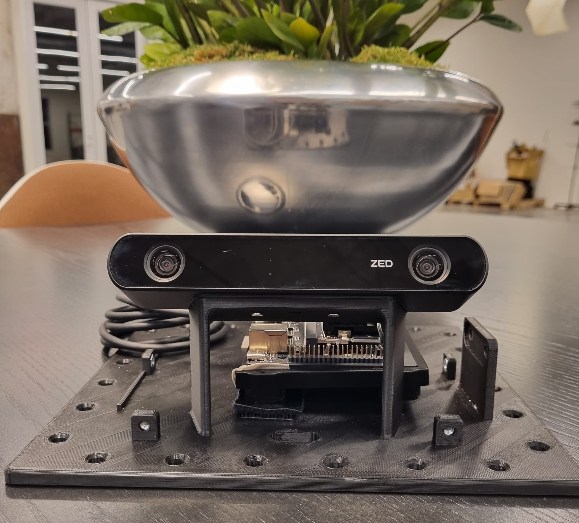

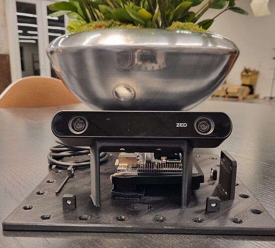

I tested the setup in the real world on two cameras: ZED 2i and RealSense D456. Both cameras have different properties and point cloud accuracies, which are tied to their baseline and other camera properties. To get the 3D designs and real-world datasets, contact me at shubhams@udel.edu. Because of the size of the datasets and storage limitations, I am figuring out how I can share them, but meanwhile, if someone wants to give it a try, shoot me an email, I will be more than happy to share the designs and datasets.
Front View
Side View
I have tilted the camera slightly for this handheld setup to avoid capturing moving people, etc., but on a drone, the desirable angle would be forward-facing.
