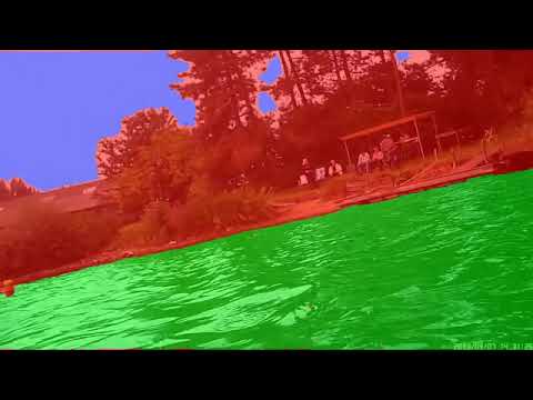

Segmentation Demo

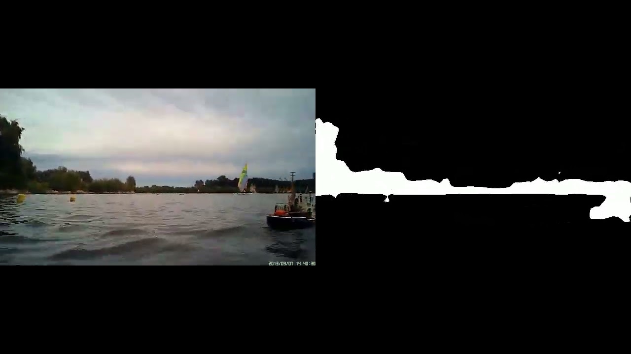

  1. Segment Anything Model has been utilized for dataset generation. Users can automatically annotate the pictures they take (ideally from the perspective of the on-boat camera) using their gaming PCs (with 4GB+ VRAM NVIDIA cards) without human intervention. Then they can retrain the DDRNet model for the Luxonis camera and get greatly improved recall & accuracy. Typically the whole process can be done in several hours.

(Red - Obstacles, Green - Water, Blue - Sky
Due to the fixed prompt points, the result is not always accurate, especially when the trees occupy the position of the sky, but it is still usable.
Therefore, the option to segment water and obstacles only is provided.)
(Left: Use Segment Anything Model to auto-annotate, then retrain
Right: Only trained on MaSTr1325)
