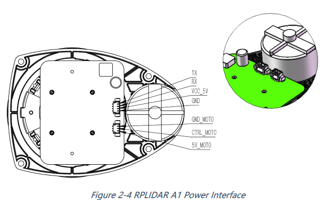

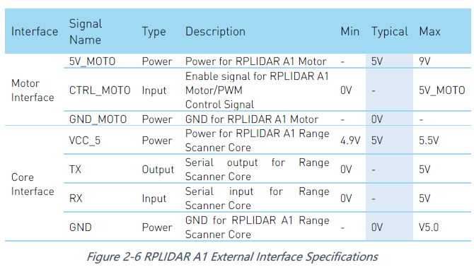

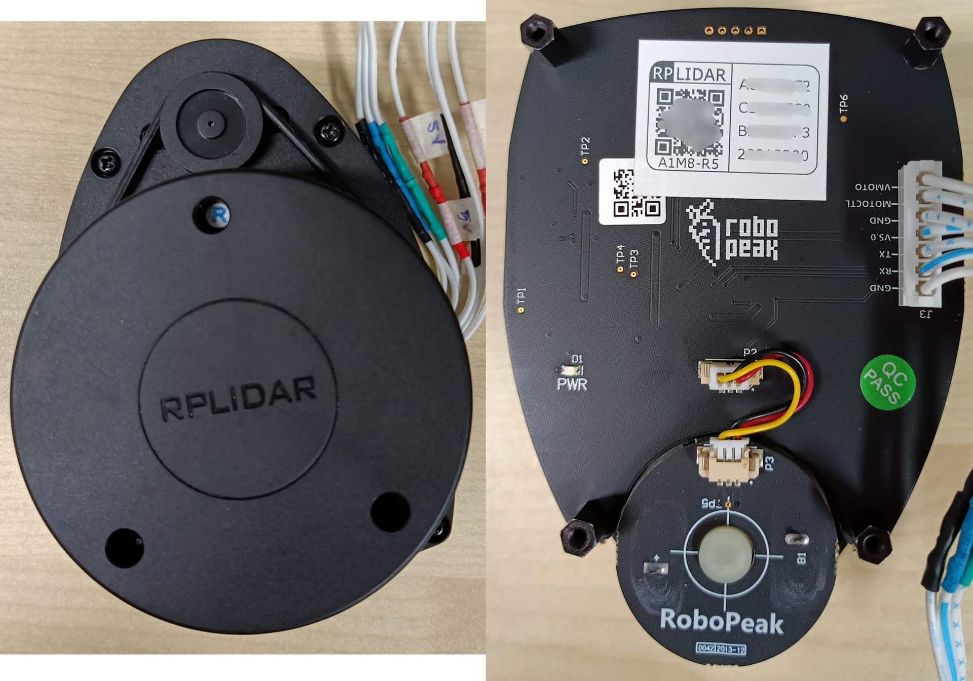

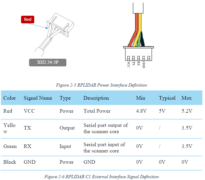

What are the signal pins from RPLIDAR do you use with RPi?
Did you use the Motor Interface signal pins?
TX and RX from Lidar to pi :white_check_mark:.
Make sure you have RPLIDAR Ground to Raspberry Pi ground connected together, even when you use a BEC to power the RPLIDAR.
It is possible on your lidar that the spin motor has its own power supply option trough the MOTO connector (you have to look at the manual for that!). The lidar I use (RPLIDAR C1) has motor power from one source.

For the Moto plug: you can just apply power (accordingly) to the plug to make sure it runs when power to the flight controller is established (it will run constantly on startup without getting into trouble. No need to turn it off or on). Make sure you also put 5 Volt to the CTRL_MOTO to establish spin. If you keep that on 0 Volt, it wont spin.

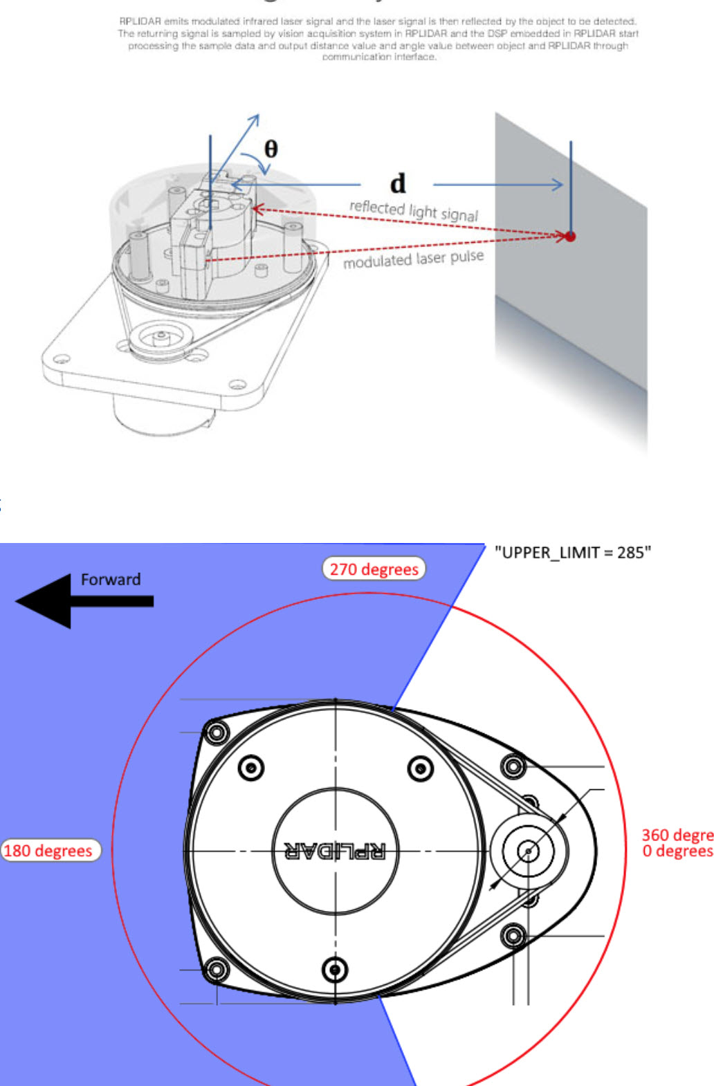

frame= 0. Just make sure you put the lidar front faced on the copter (look at the manual from the Lidar what is front face).

Thank you, this is a very important piece of information. PWM signal control for spin speed.
I searched both the C1 and A1 user manuals and datasheets, neither of which mentions front-faced mounting. Can you help explain a little?

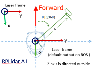

To give you the idea and example: LIDAR with 360° FOV
In scan_to_mavlink_node, I set dist_msg.angle_offset = 0)
If your LIDAR gives 360-degree scans and you map those to the ObstacleDistance message:
distances[0] might represent 0° (straight ahead)
distances[90] → 90° (right side)
distances[180] → 180° (behind)
distances[270] → 270° (left side)
In this way Mavlink knows on what position the obstacle is (if there is any) according to your copters frame.
In my case (RPLIDAR C1) there is a arrow sign :up_arrow: on top of the lidar.

Did you draw the image shown above? Where did you find this image?
No such arrow for A1.
It’s easy to allocate what is forward.. just hook up the Lidar and use software (in my case I used Slamtec Robostudio). Place the lidar strait on the table and see trough the software where the obstacles are located, look back to the lidar and see how the lidar is orientated, comparing to the obstacles. In this way you can determine the forward position of the lidar. And no. I didn’t drew the drawing (there are many out there).
Your project is incredible. I also have a Rplidar C1. My question is: are you connecting it with the USB adapter that comes with it or are you using the UART port without the adapter, or how are you connecting it? Regards.
I don’t use the USB, even the usb has a higher baudrate. ttyAMA1 -p serial_baudrate:=460800. The Lidar is listening to 460800 what is fast enough over serial to the PI.
