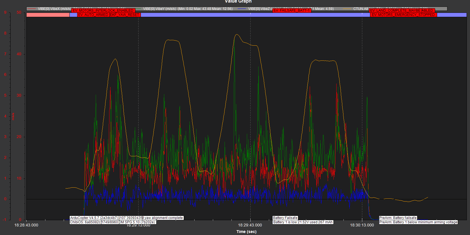

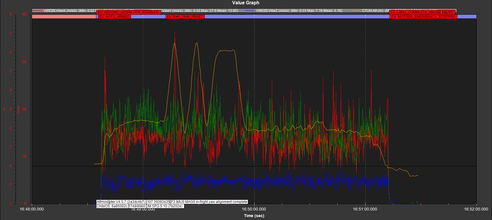

Upon reviewing the flight logs, I noticed that most vibration levels remain below 20, which appears acceptable.
However, I observed significant vibrations specifically during throttle changes, particularly when the altitude is changing.
I suspect this could be due to prop wash — though I am open to other explanations.

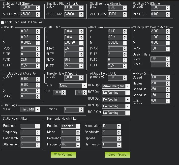

The current relevant parameters are as follows:
  • PILOT_SPEED_DN = 250
  • PILOT_SPEED_UP = 300
  • PILOT_ACCEL_Z = 250
  • PSC_JERK_Z = 5
  • MOT_SPIN_MIN = 0.08
I have tried increasing the MOT_SPIN_MIN value, but it did not seem to make a difference.
I also slightly reduced the ATC_RAT_P values for roll and pitch, but that did not help either.
I would greatly appreciate any suggestions on what else I could try to reduce the vibrations during throttle transitions.

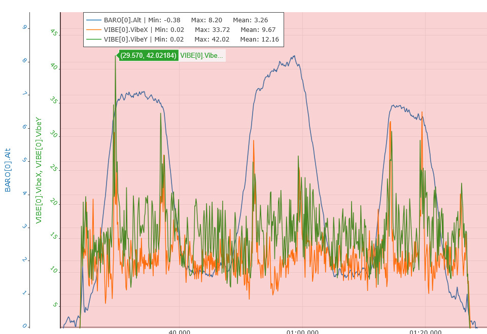

I’m seeing sharp spikes in vibration when the drone stops ascending or begins to descend.
This could possibly be related to the heavy payload, but considering that MOT_THST_HOVER is around 0.18, I don’t think that’s the root cause.

Your filtering looks OK for me now, but your PIDs are way too low, it’s not effective if propwash. Please try with stock one, should be OK for 7", but anyway you need to redo autotune after filter change.
As you mentioned vibe happens on altitude increase, so it’s unlikely a propwash,

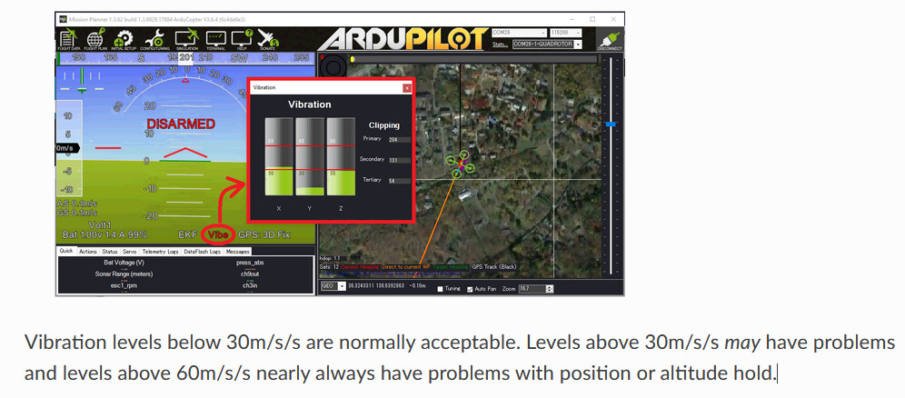

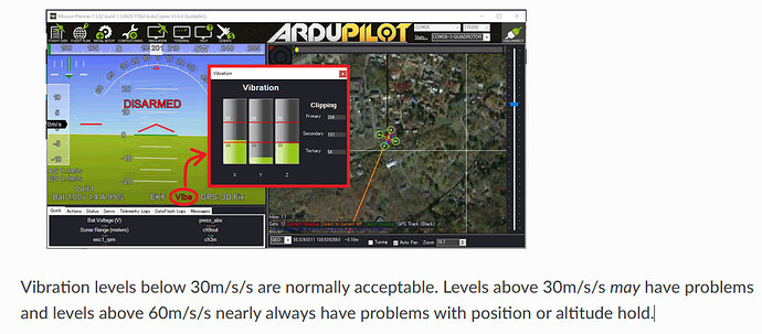

so it maybe just frame/props vibrations on state change. Vibe levels up to 30 are acceptable according to docs.
30 is too high. What docs say that 30 is ok?
Docs says that up to 30 is normally acceptable.
Thanks, we should update the docs then. 20 is better as a limit.
30 gives you a false sense of safety.

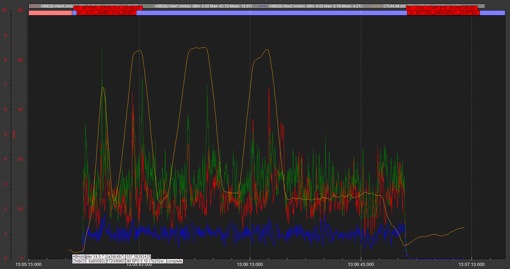

Over the past few days, I’ve continued test flights with my drone.
Unfortunately, the vibration levels have not improved.
My goal is to bring the hover VIBE down to around 10.

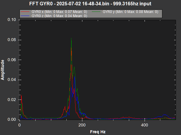

  3. Despite applying a notch filter at 165 Hz, the FFT analysis still shows significant noise at that frequency.
    Would it be worth trying to reduce the bandwidth to around 60?

This is my last flight log.

You are using the wrong tool. Use the Filter Review Tool.
Delete the 2nd Notch it’s not needed. And certainly not 2 throttle based Notches. The Filter Review Tool Estimated Post Filter will show you that.

Overshoot is typically a sign of them being too low so in that regard @mike_tk is probably correct but default PID’s would almost certainly cause output oscillation on a 7" with the thrust/weight you have. Every craft is different but you could try .06 for the Rate Pitch/Roll P&I and .002 for D.

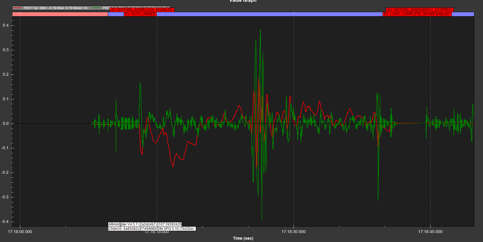

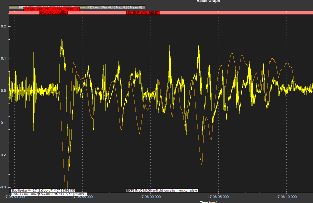

I did a short flight today and found from the logs that the Yaw PID is not tracking the target well.
In the first graph, Yaw P was set to 0.1.
In the second graph, it was increased to 0.12.
I know these PID settings are not ideal, but looking at the graphs of the Target (Tar) and Actual (ACT) values, I’m not sure if I should further increase the Yaw PID values.
The D value is currently at the default of 0,
but I’m thinking of trying a small increase, like 0.01 or 0.02.
I would really appreciate any advice you could give me.
Run Auto Tune YawD then back to Pitch/Roll tuning.
