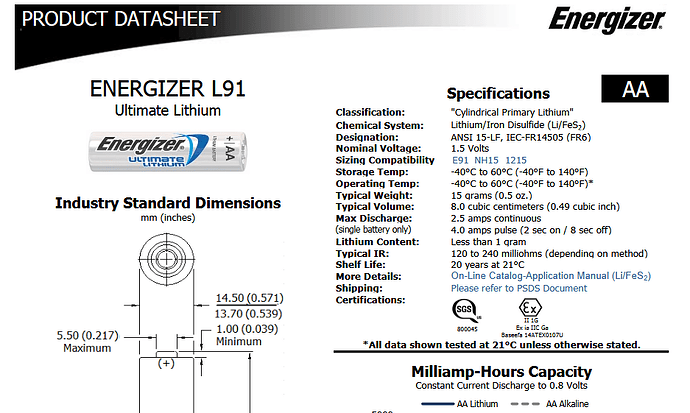

if its just gliding look at disposable lithium batteries, they are good down to about -40c, you can buy them just about anywhere that sells AA batteries. I think they are around 3.3AH.

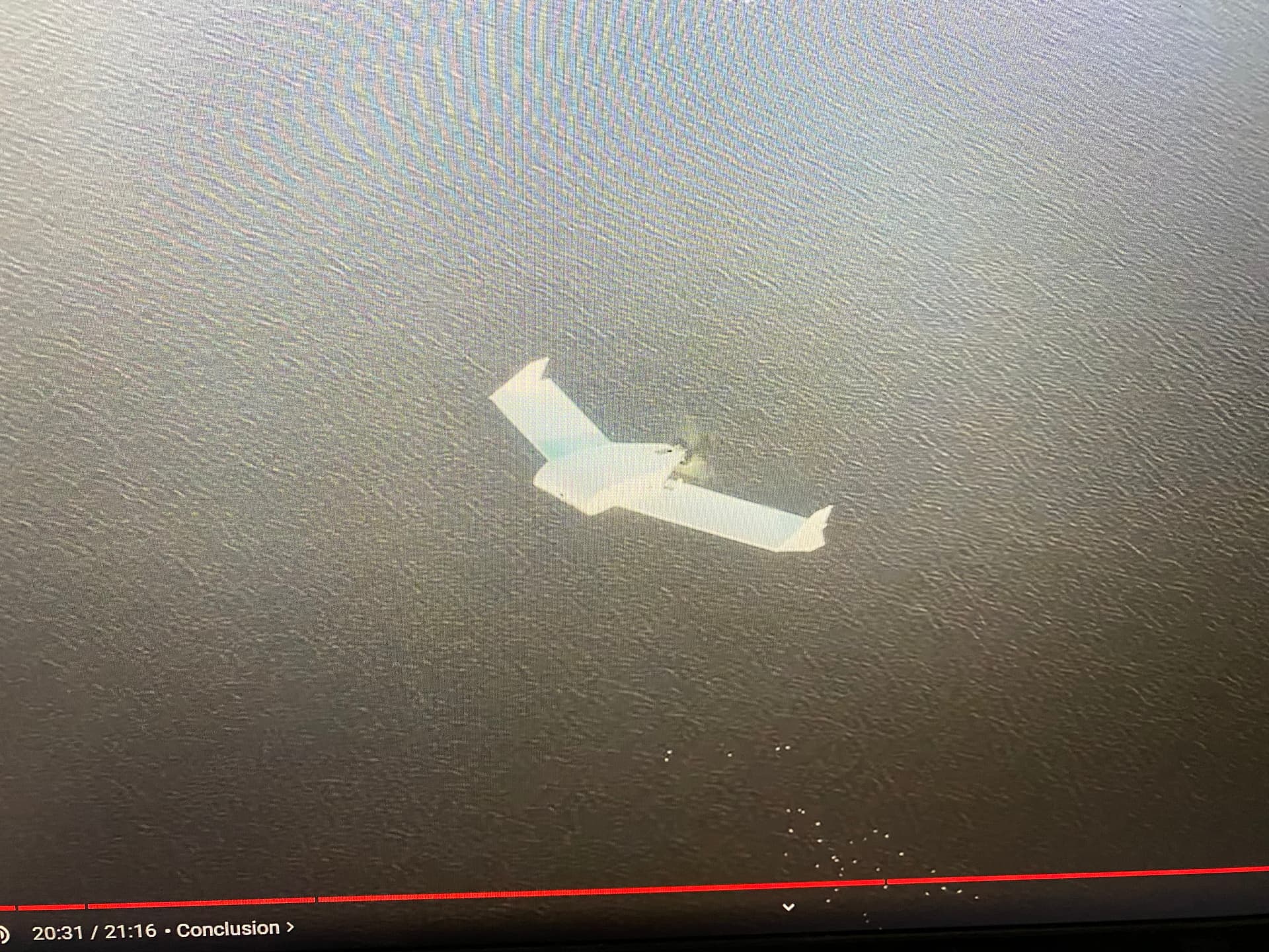

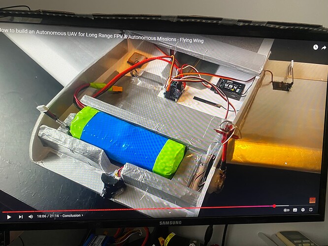

Watching the flying wing on YouTube, https://www.youtube.com/watch?v=SA-BsyLVYNk
I see it has a GPS, a flight controller, and other components like a video transmitter and RC receiver. Can you use it to fly the wing without using the video transmitter or receiver? That is, program a landing site and have it glide there on its own? That’s what I’d like it to do. I see the BN220 or BN880 GPS on the materials list. Which of these two GPSs is better and is smaller and lighter?
Same question with the flight controller. MATEKSYS F406 wing V2, F411 WTE, SPEEDY BEE F405? The lightest and smallest? That way, I’ll bring the necessary materials to later build the wing (I also need the plan… If I become a YouTube member, will they let me download the plan?). Thanks. As you can see, I don’t know anything about this autonomous thing… I’m just learning. I’m a normal aeromodeler, just into RC planes and nothing else. It’s all new to me. And then how to program and with what… those are other questions that will come later.

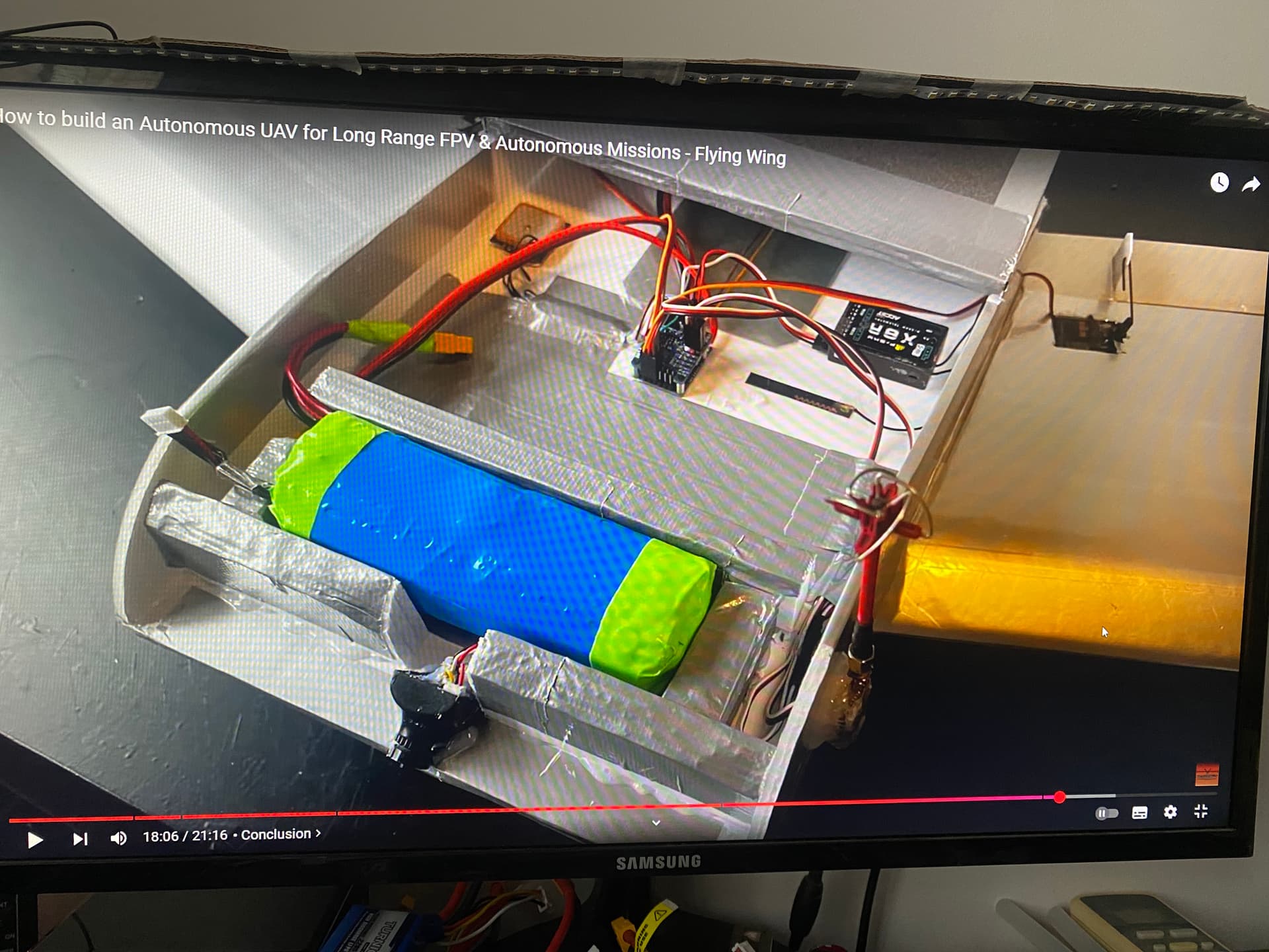

This is the example I saw, and it’s very close to the idea we have for the balloon… something practical and capable of installing electronics and batteries. The inquiries I’ve made are based on these images… and considering that I don’t need to control it with RC equipment, I don’t need a receiver, camera, or image transmitter. At least in this balloon model, which is small in volume and payload. Perhaps, later, if we get good results with this first project of a wing hanging from the balloon, we can apply the knowledge to another larger balloon, so it can carry more payload, with a wing, and then be able to SEE and control it from the ground when it comes within radio range. This will be in the FUTURE. Now, we want to conduct the first experiment with a light, small payload. I greatly appreciate all the attention and patience you’re showing… I continue to learn at 66 years of age.

It seems like you are very new to ArduPilot and the RC world - so maybe worth buying a cheap Fixed Wing kit and learning the software/hardware before embarking on this project. You could easily re-use the autopilot/GPS/radios bought for the kit/cheap aircraft in the ultimate aircraft used for this project.
You will need RC control and telemetry link for tuning. Video is not necessary.
After you have configured and tuned your plane you can configure it for link less operation though AFAIK in EU and USA flying without any control link isn’t legal without appropriate paperwork.
For your setup you will need
  • Flight controller, I would definitely go with H7 based one as it is much much easier to customize behaviour with lua than modifying C++ code.
  • GNSS receiver, anything with uBlox M10 and preferably compass
  • Airspeed sensor, anything compatible with Ardupilot will work though I would avoid analog sensors. It will let TECS work with no motor and be more reliable than synthetic airspeed.
  • RC setup
    • RC receiver, go with ELRS as it is fairly easy to work with and can support MAVLink telemetry
    • RC radio, I would recommend going with something running EdgeTX as then you can use Yaapu’s telemetry script. Radiomaster makes good radios.
Manav is right, learn Ardupilot on a cheap 4 channel plane before playing with extreme range and altitude automatic flight.
