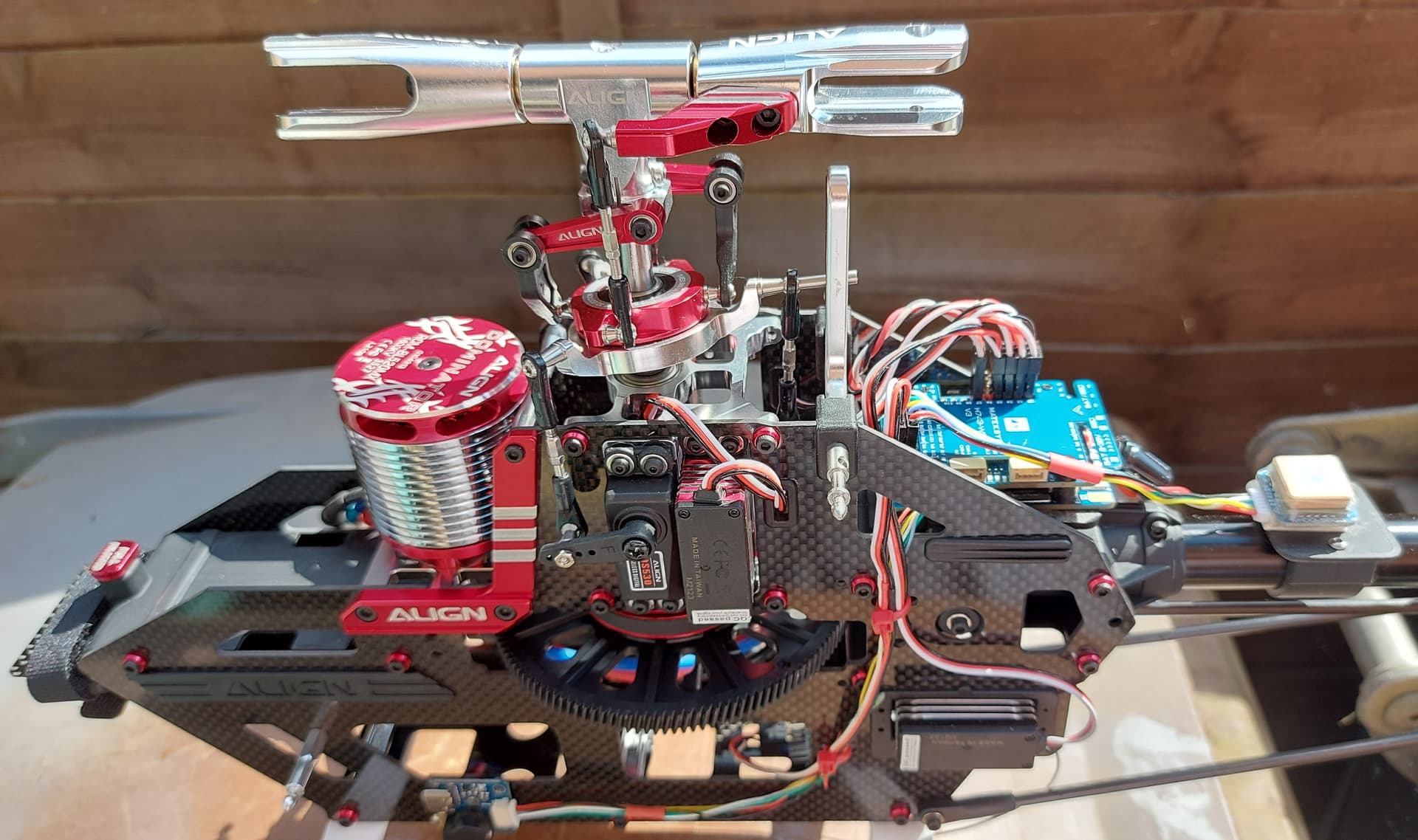

Can you post photos of your set-up, especially autopilot mount area? Either something is seriously out of whack or you got resonance.
Thanks for your reply Lupus. But remember, the vibration of the frame is visible to the eye, so location of the FC is not the cause. I can maybe optimise the FC mounting once I’ve fixed the vibration.
Anyway, here’s a pic of the setup. The general layout is exactly the same as my other two older 500s and a 550, neither of which have vibration problems.

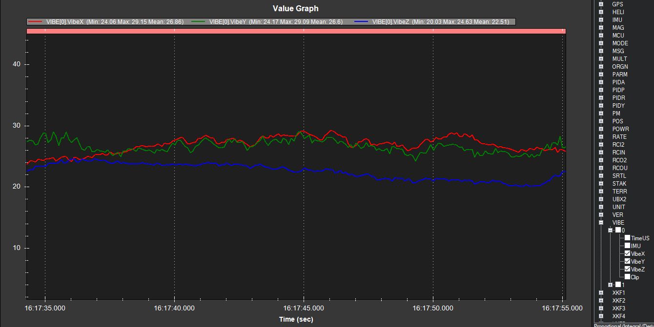

Inconclusive results this afternoon, I think. Following are the maximum vibration levels recorded in various scenarios:-
  1. Z = 56.81, Y = 44.77, X = 55.12 First flight, skids seen to be vibrating badly
  2. Z = 54.51, Y = 31.63, X = 64.72 Main blades removed
  3. Z = 56.09, Y = 36.56, X = 55.91 Tail rotor hub and blades removed
  4. Z = 42.74, Y = 56.33, X = 82.04 Main rotor assembly removed
  5. Z = 32.10, Y = 47.10, X = 88.02 Motor disengaged from drive
  6. Z = 37.07, Y = 31.03, X = 82.22 Motor re-engaged
Note that #4 and #6 are the same configuration apart from re-positioning the motor.
Close visual inspection during #4 revealed no wobbling of the top of the main shaft or the top of the motor. The only ‘defect’ I can see is that the main slant drive gear is slightly warped in the horizontal plane, so I’m going to replace that before going further.

Today I disassembled and reassembled everything and found no mechanical issues, reduced the head speed to 2100 (as low as the CC programmer will allow with 12T pinion and 134T main), and had a short hover. The visible rapid side-to-side shaking of the skids was still obvious, starting about a second after the copter got airborne. But looking at the vibe graphs I see that the overall maximums are noticeably lower than my initial flight and, perhaps more importantly, if I ignore the spool-up and shut-down they’re all below 30 during the hover period.

Did another test hover today with ATC_RAT_RLL_P reduced to 0.012. Skids still shaking badly, but am I imagining it that the shake is less?! Log shows vibe results very similar to previous best.
