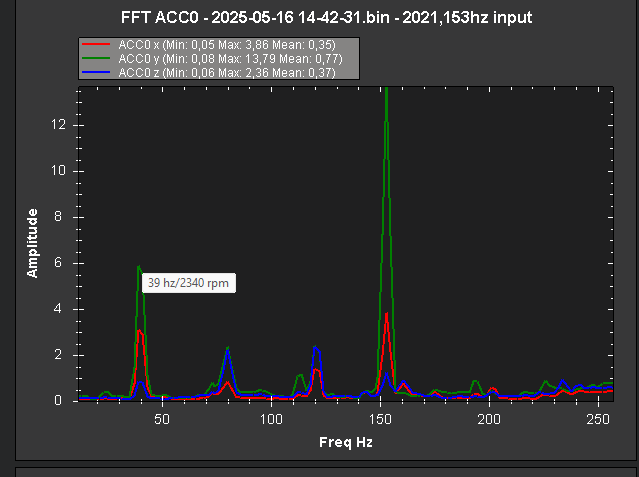

Looking through your log, I had the confirmation I was looking for:
Also, you mentioned you are running 2100rpm headspeed, did you double check that with a tacho or is it the estimation from the Castle thingy? because the FFT says it’s 2340 rpm (lateral dominant- so it’s definetly main rotor):
Thanks for looking into this so deeply. I relied on CC’s data; I’ll have to find my tacho and put a new battery in it so I can check when I go to the field tomorrow.

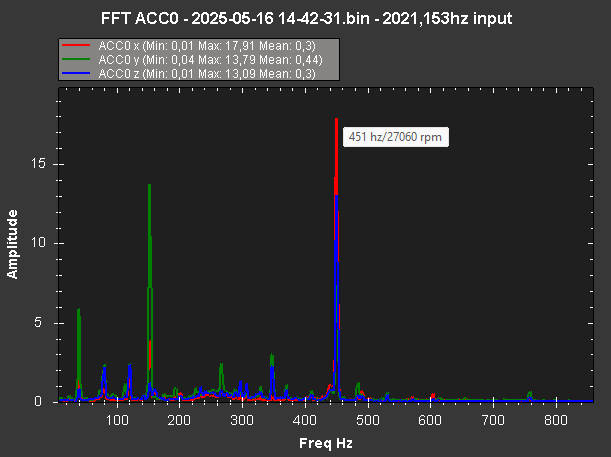

I can see where you get 2340 from, but what does the higher peak at 27060 represent? Presumably that’s the motor itself, for when I take the gearing (12/134) into account I get a similar result of 2423 rpm.

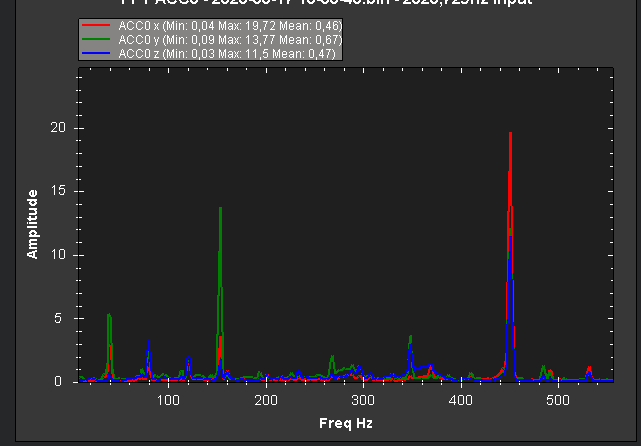

Is this any better? Today I moved the motor pinion by 90 degrees – it has two grub screws on it, one of which engages with the flat on the shaft, so I swapped that with the other one that just grips the round part of the shaft.

Doesn’t look like it:
My tacho said 2420 today, so matches the recorded motor rpm peak corrected for the gearing.
Thanks for the tip about Ctrl-F. Any further analysis can wait until I’ve installed an 11T pinion that’s on its way.
