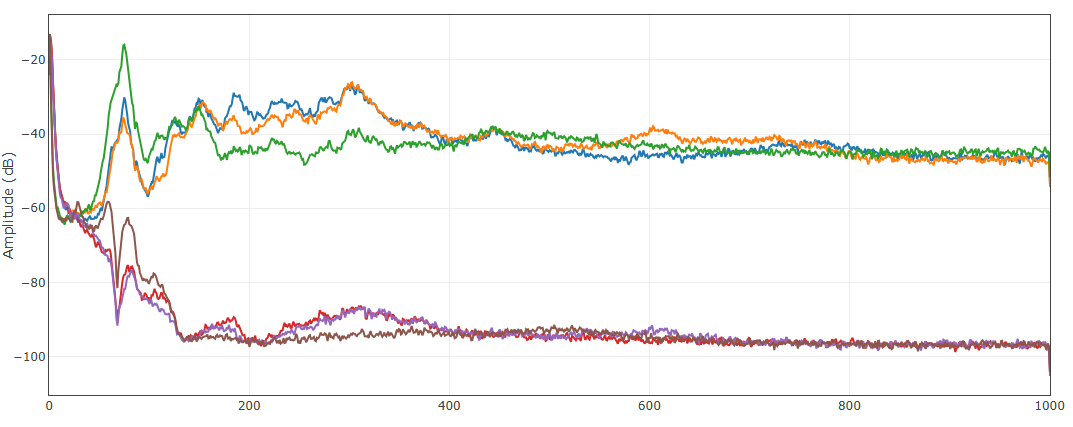

Results using FFT + Fixed at biggest spike
CPU at about 30+%
You should reduce attenuation to 30dB or less
I would also increase bandwidth, as You can see 2 side peaks in post filter. And perhaps “Update at loop rate”

Here is better view, dotted is fixed while solid is FFT.
@Adam_Borowski I think 2 side peaks you mentioned are not peaks but sides of fixed filter .
It seems 2nd FFT harmonic hits same frequency as 3rd of fixed filter.
Guys I’m so sorry. I do not know how it happened but I was sure I set FIXed as 2nd notch. While 2nd image clearly states it was set to Throttle. Will have to fly it over again.
Will test that setup tomorrow.
FFT itself can’t handle first spike at about 70Hz
Is Your FFT_MINHZ below 70 ?
Those examples have a lot of overlap in the filters. If you’re willing to share a log I’d be willing to take a crack at it.

Without 2nd notch, FFT only.
Brown is to high, that’s why I applied simple and fast FIXed to it.
