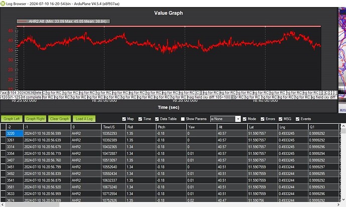

I’m trying to extract the following data, Timestamp, attitude, altitude, lat/longitude. However, I’ve been struggling the extract the data in the same format that is shown in the “Review a Log” feature in Arudpilot.
Ideally, I’d like to extract this table straight to Excel to do some analysis. But, I’m not able to copy this table nor download it.

Isn’t the 2nd column a time stamp?
Have you tried the “Convert .bin to .log” button. The .log file generated is also a comma separated file
Either this, or you should be able to CTRL-A select everything in the log browser, CTRL-C, and paste it into Excel.
