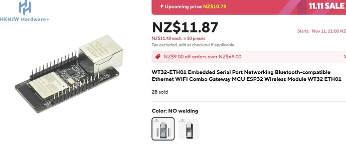

Has anyone found a serial to ethernet adaptor board?
I have a number of drones using Cube Orange+ but the carrier boards do not have ethernet capability.
Have a look at the HM30, quite a nice radio system from SIYI
Thanks.
Not after a radio. Just need to convert serial to Ethernet onboard the drone.
Not had much luck with siyi kit so I’m staying clear of it from now on.
You may want to take a look at this.
in that case, https://likeabird.eu/ethernet-switches-and-gateways/ might be a solution for you
Im hoping for the talked of ESP32 - PPP - Ethernet code to materialise. Any info or updates anyone.
