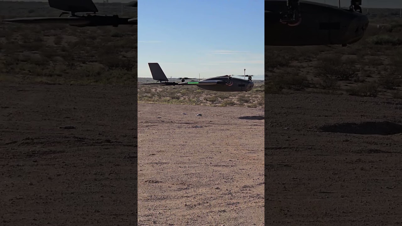

This is a heewing t2 vtol. So i dont expect much

How do i check that? Its much better than before. Wings vibrating and the tilt servos were shaking. Log was full hence the yaapu beeping. It was also windy around 10 to 12 mph
Putting those big squishy mounts on that probably will just make it behave worse due to poor coupling between actual attitude and the board itself.
I’m assuming the higher vibration portion of the flight is before transition. It’s slightly high but not out of control. Secure all loose wires and tighten anything loose on the frame. Do that before resorting to softer mounting.
