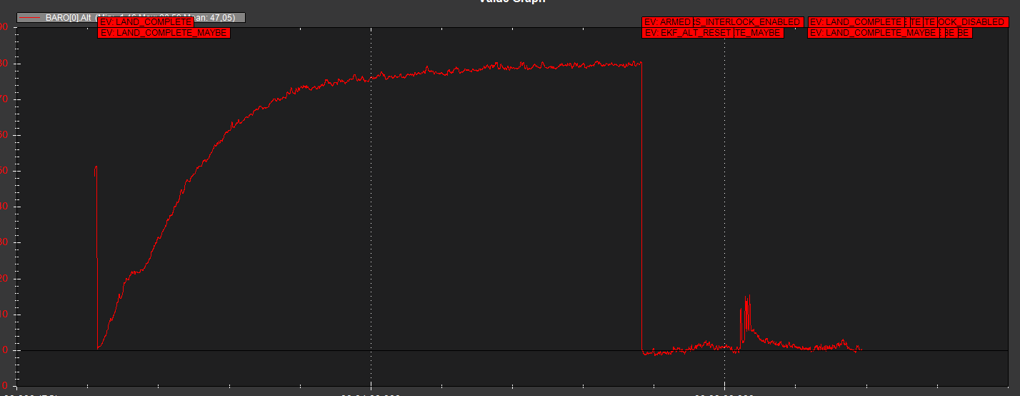

Pretty sure that’s an SPL06
Yes, I found it by using a number of drivers. It works best as SPL06, but still, it is just a bad chip.
It doesn’t matter if it is broken or just of poor quality.
On, resting for 8 minutes, then armed. In house.
Do you know if it can be replaced by any other baro?
A friend of mine is an SMD soldering master. He can do it easily, the question is if other component fits 1:1.

It works on both, but the SPL06 performs better, little.
And it looks like SPL06.
Thought the SPL06 was a clone of the BMP280. But I suppose that’s irrelevant.

There is a broader issue with the SPL06 family of barometers, which appears to be related to temperature calibration.
This is what I can confirm :frowning:
Betaflight promotes the DPS368 as a reference barometer.
Market problem is that China is flooded with SPL06 barometers lacking the DPS368.
I am waiting for a new board and I’m hopeful to find DPS368 on it, but can’t be sure.
In the meantime I am working on the current SPL06 driver, but it will not function correctly if the calibration is incorrect.
Add Sensor Driver of SPL07-003 · betaflight/betaflight · Discussion #13420
The best performance I could achieve from that chip even after altering the current driver slightly.
10 deg Centigrade diff in 20 minutes time.
Question is, if it looks good or bad?
