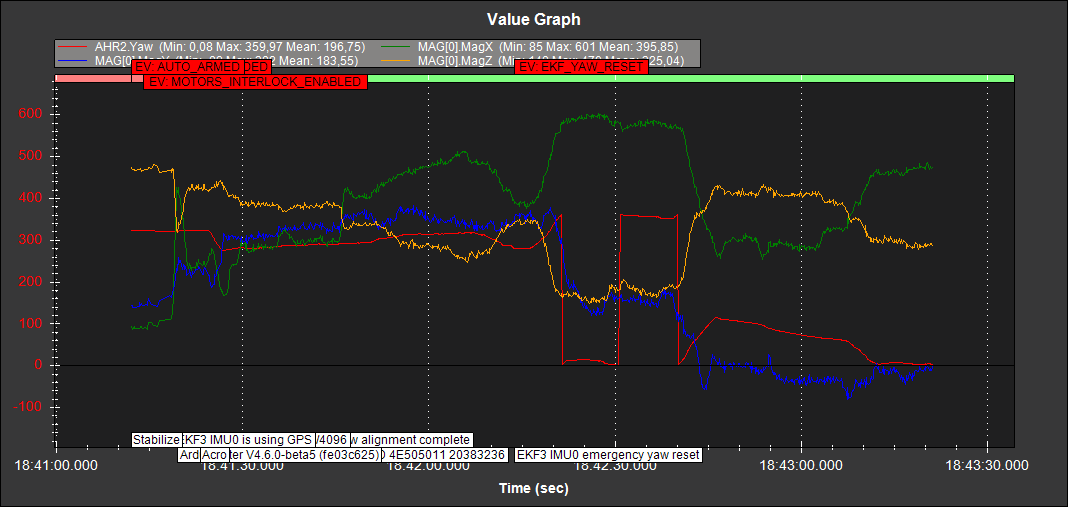

So this showed on my OSD but the quad continuing flying normally. I was making a slow left turn when the OSD heading jumped from 239 to 261 degrees. 14 Sats. No change in flight behavior.

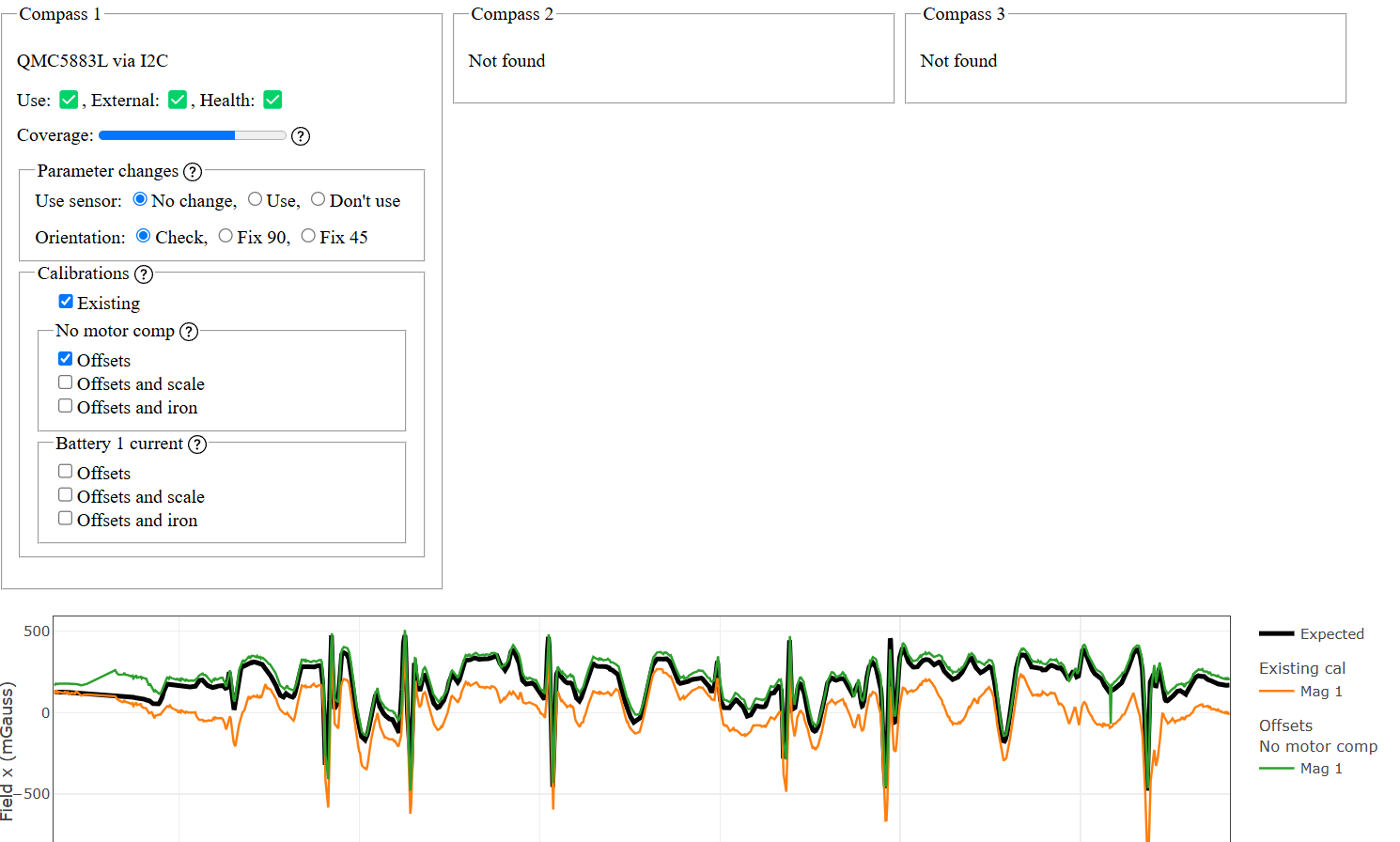

From the black box I see nothing weird in the magnetic field. Could this be just a case of bad calibration? I did recalibrate when I switched from a 4S to a 3S battery

2- Flew, did all kind of flips and roles then saved MagFit offsets

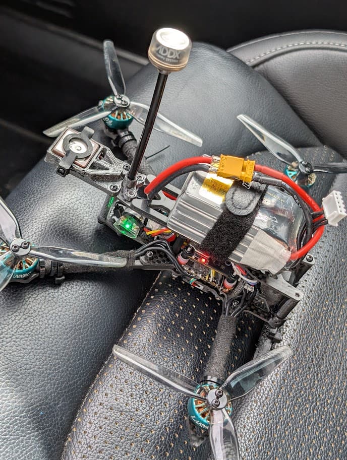

The quad: 4" dead cat frame with the GPS at the back
