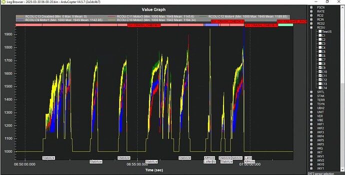

I’m attaching the motor RC PWM log and throttle log. Do you think the motors are underpowered and I need more powerful motors? The final weight is 1.57kg.

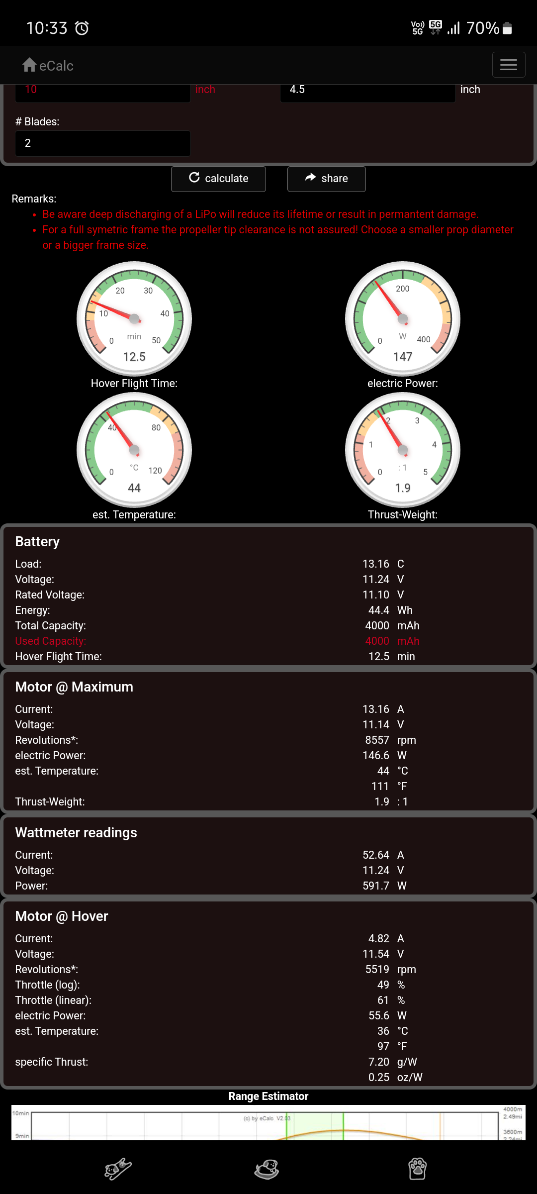

Also ecalc just calculated my quad’s TWR as 1.9 which is optimal as far I have read online.
It’s not optimal it’s underpowered/overweight. With the correct info into eCalc the Motor @ Hover throttle linear is 71%. It needs to be below 50%. You should have built for 4S power like most do with these frames.

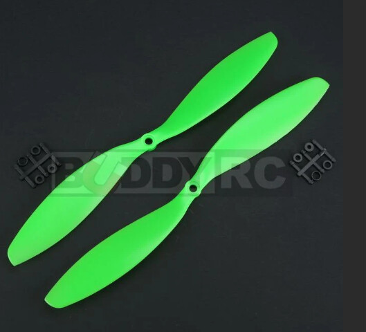

If you can not change power train to 4S you may consider changing props to something like 11 or even 12.
Look for one call Slow Fly. They are designed for KV engines like yours, providing high thrust with slow rotation.
Slow Fly (Electric Only) Archives - APC Propellers
Using such a props I fly 1,3kg drone with 1145 props on 3S.
Hover is at 20% throttle.
I use those
Gemfan 11x4.7 SF

So it turns out it was the disbalanced battery! I balanced the battery and added all camera gear. Total weight was 1.65kg. It flew on loiter mode with constant pitching and rolling at 5m/s (my set maximum) for around 10 mins before failsafe kicked in at 10.5V.
The quad is not underpowered as it turns out. Here is the flight log for throttle. Average throttle was around 60%
The spike before landing was a hard braking manuever.
Sure it is with a hover throttle 60%. Significantly so.
