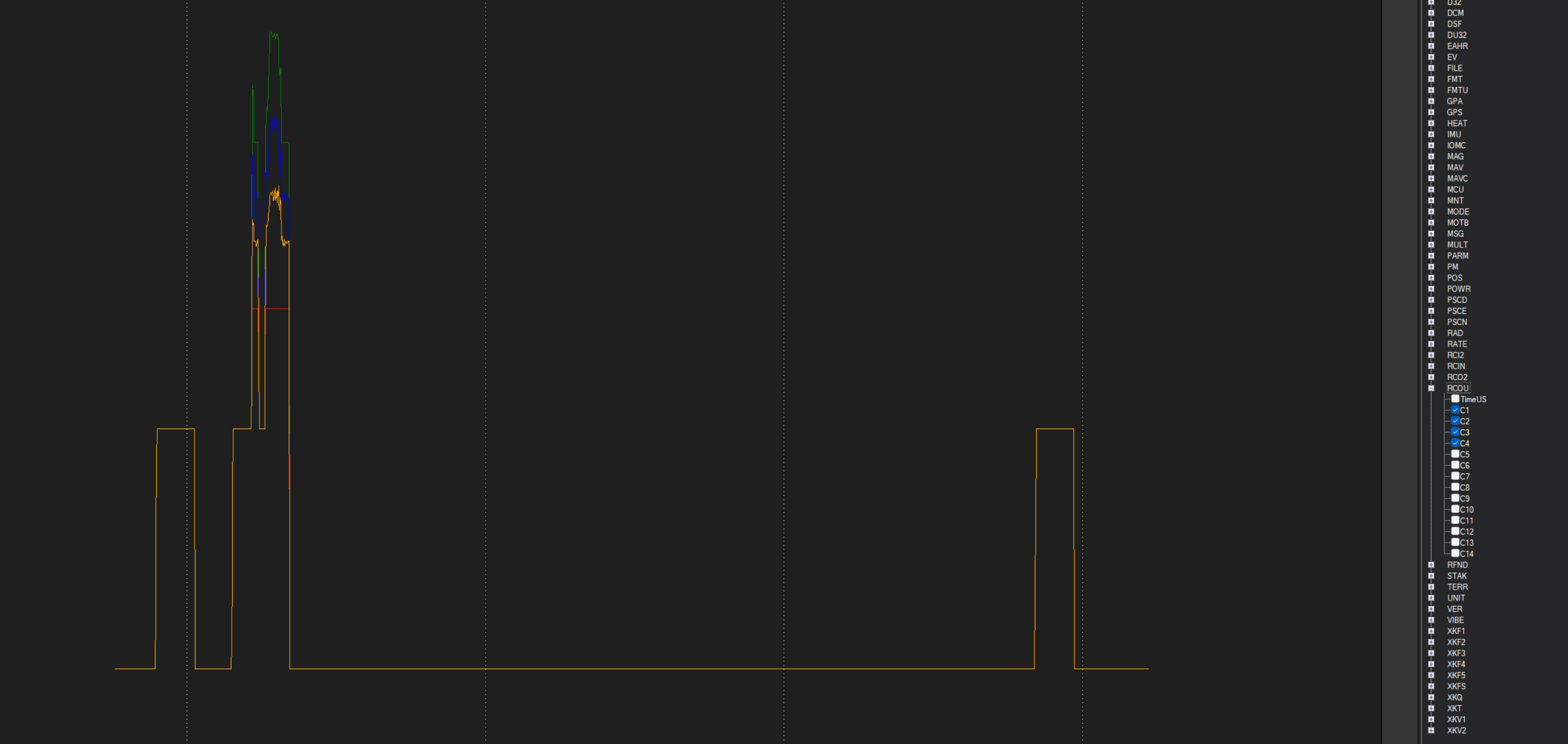

you can check the log file to see the RPM spin, how are they spinning. under RCOUT (pwm output to individual RC outputs):
you can also place the drone on a flat sea level plane and do a simple Accel Cal to see it improve the situation.

I have another problem now. I sent drone from qgc to takeoff on about 5 meters it held perfecly.
then I switched it into land mode (using transmitter - herelink controller unit) and it just fell off.
After observing the drone the power cable of one of the esc’s were cut (not entirely) and I don’t know if the drone fell off because the wire was cut or wire got cut because drone fell off by itself.
Is there any way to see that kind of information from logs. I’m uploading the logs file
