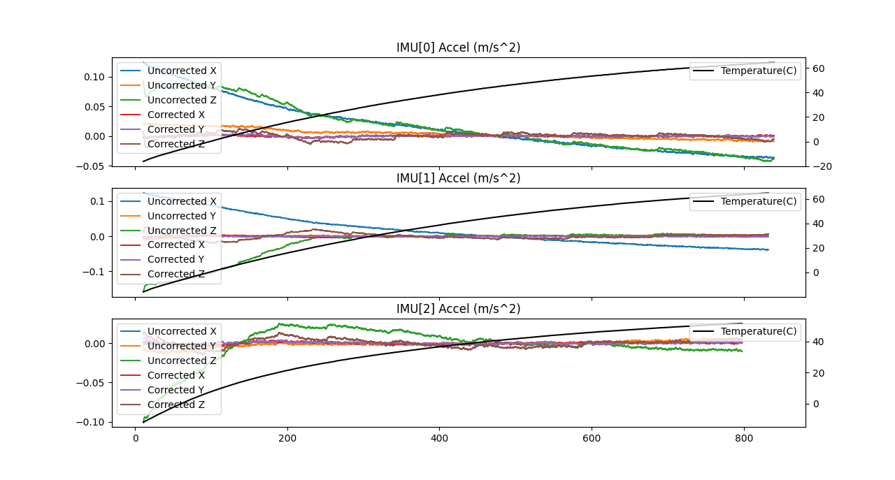

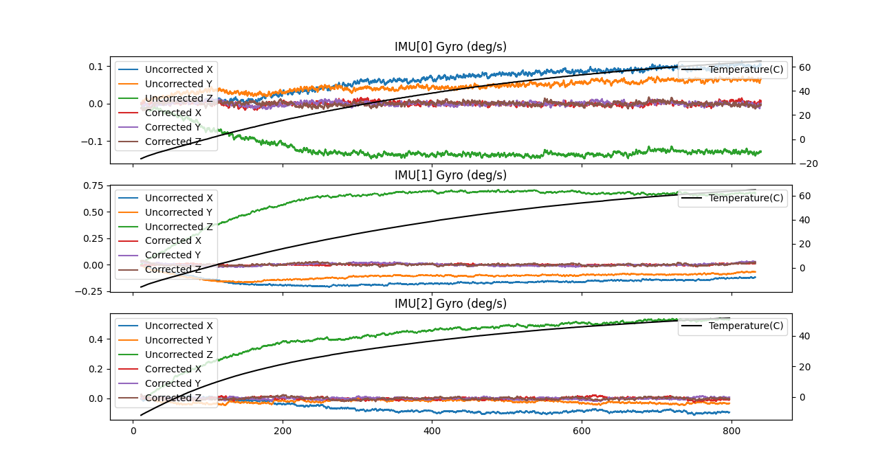

Hi @xfacta & @amilcarlucas
I am following the methodic configurator for configuring my drone from beginning.
Here is the result of IMU temperature calibration:
I suspect lot of noise in IMU[0] & GYRO[0], here is the result of Temperature calibration: 03_imu_temperature_calibration_results.param - Google Drive
That temperature calibration is something that is so easy to do and has such a great benefit !

Hey @xfacta,
Thanks for the confirmation. After the calibration, I guess the FC does not wait till the heater heat up to 40C? is that correct?

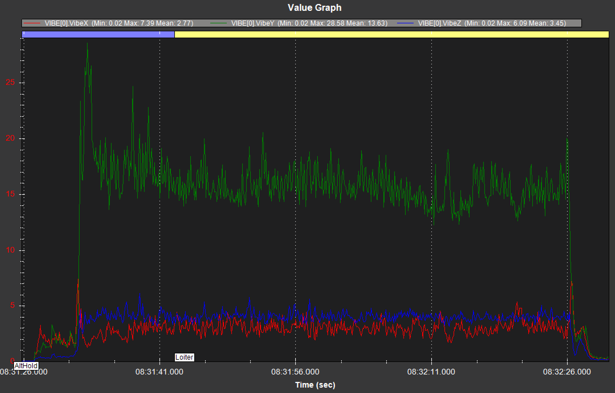

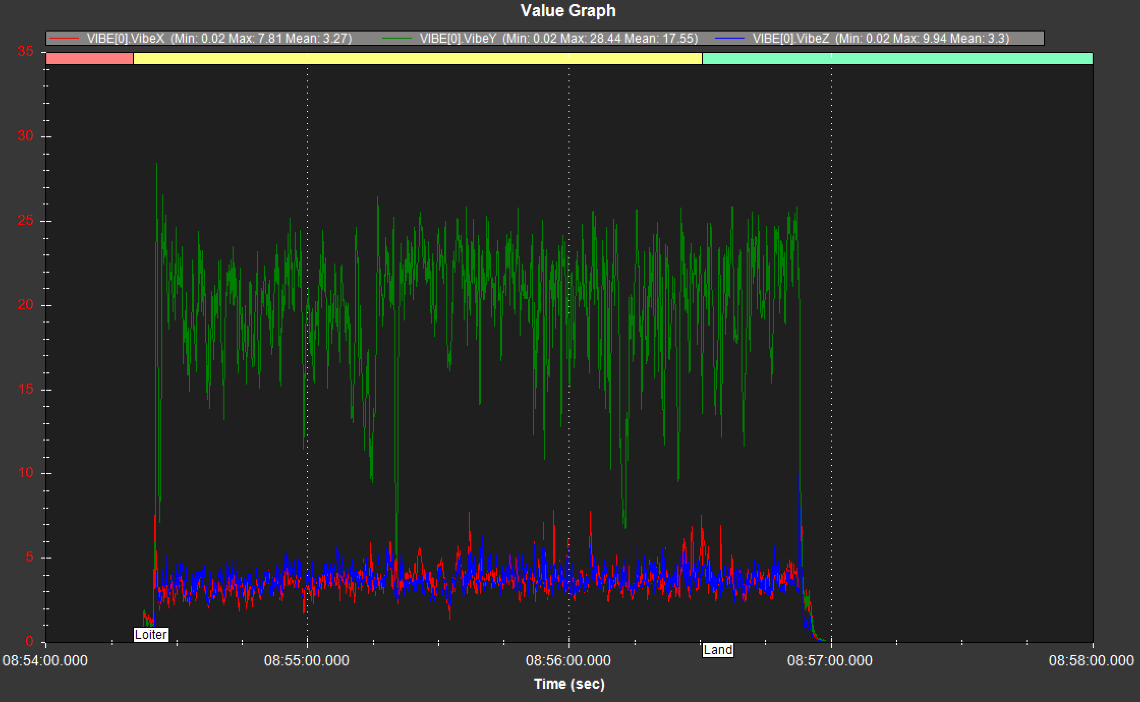

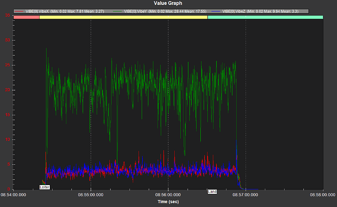

Hi All,
I have reduced the vibration in X & Z but Y axis is still high.
Y vibration are still under limit (less than 30) but I want to understand what are the factors which effects the Y vibration.
This is what I found on forum about the vibrations:
Vertical vibrations (Z) often means the track of the blades isn’t correct or equal.
Horizontal vibration (X & Y) can be blade balance or something hitting the FC during the flight.
Can anybody suggest me what else I can do to reduce the Y-axis vibrations? I have checked the propeller level and all wires fixed properly there is nothing moving in the drone. Here is the log: 2025-04-17 08-19-42.bin - Google Drive

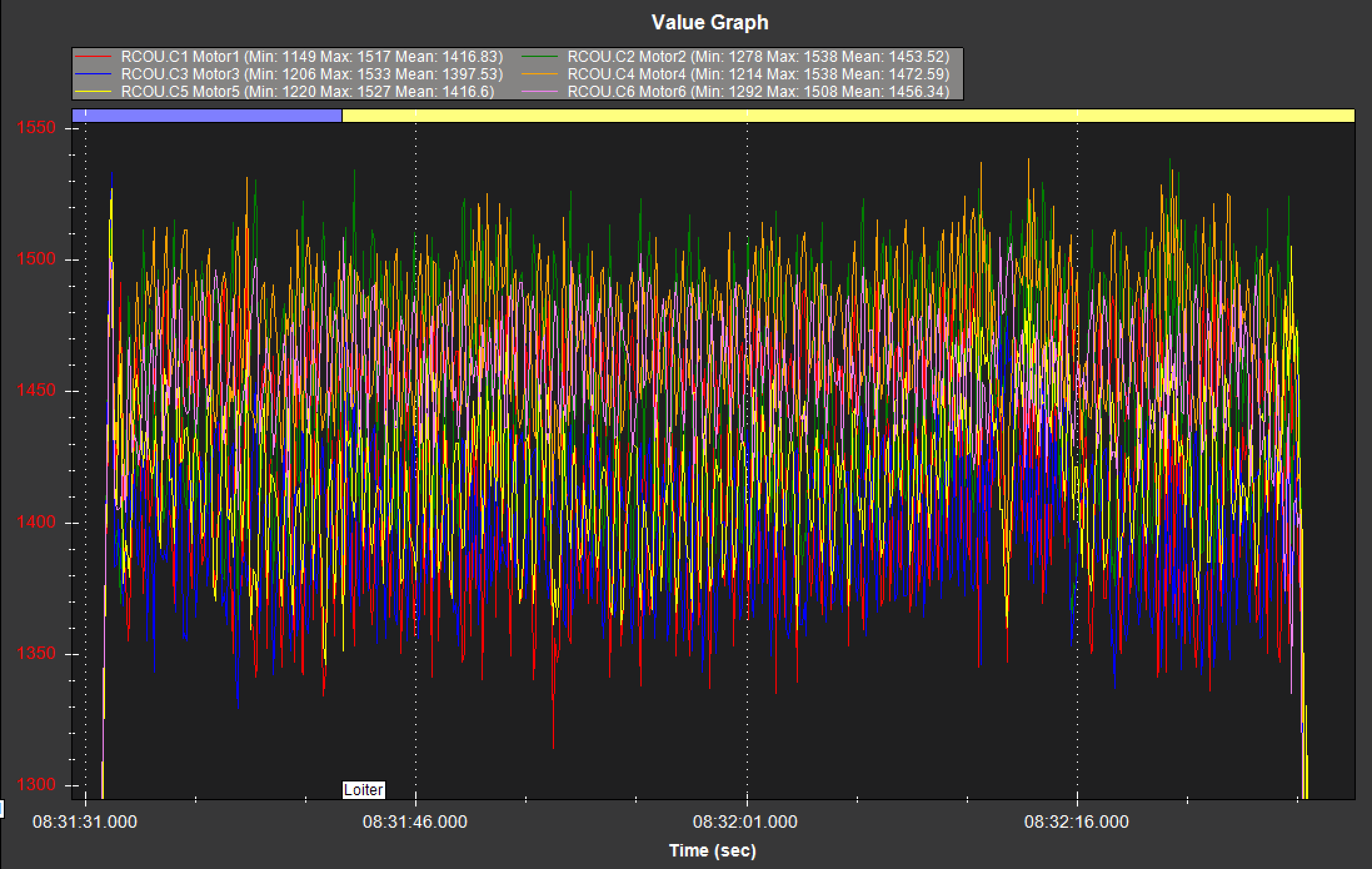

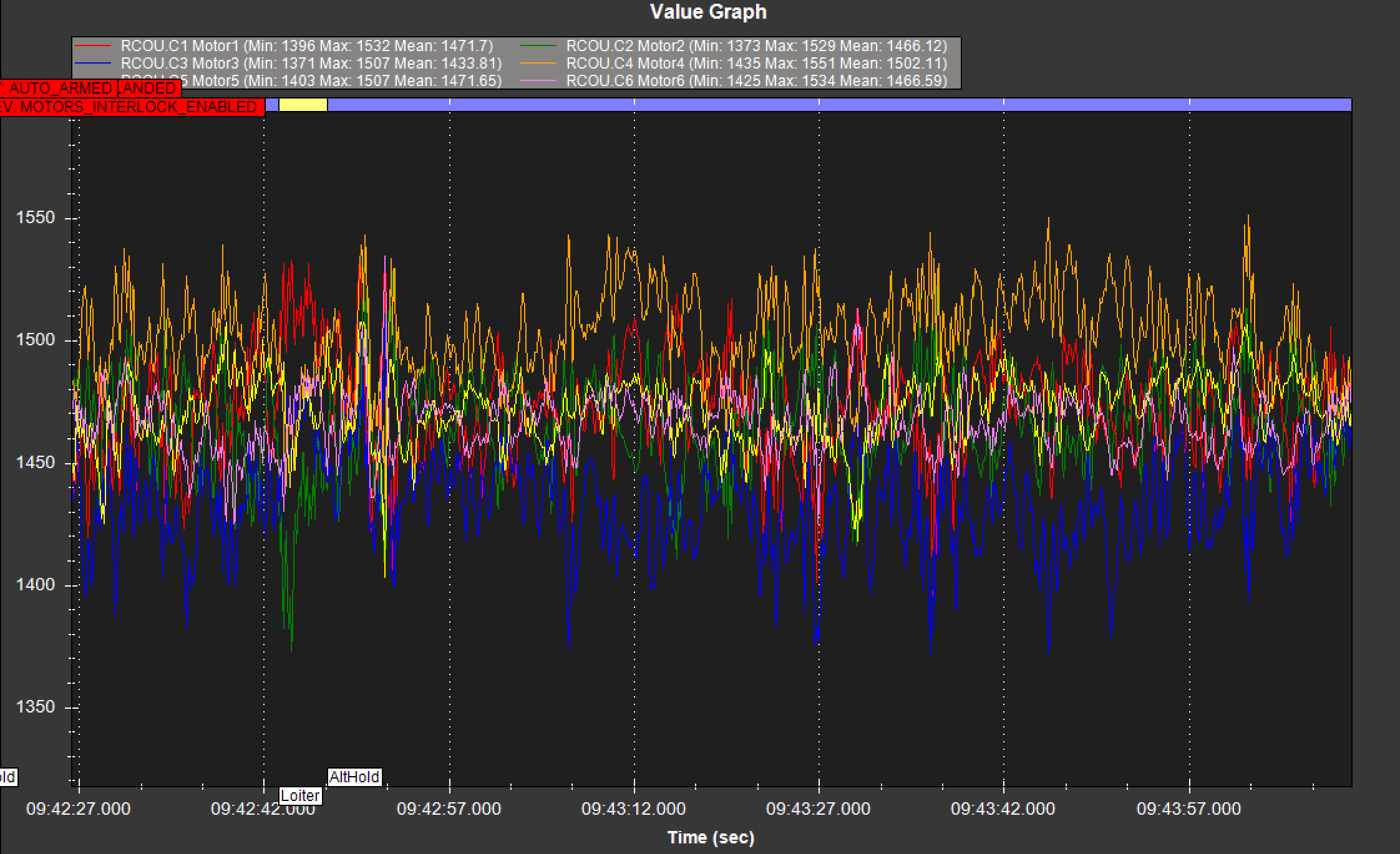

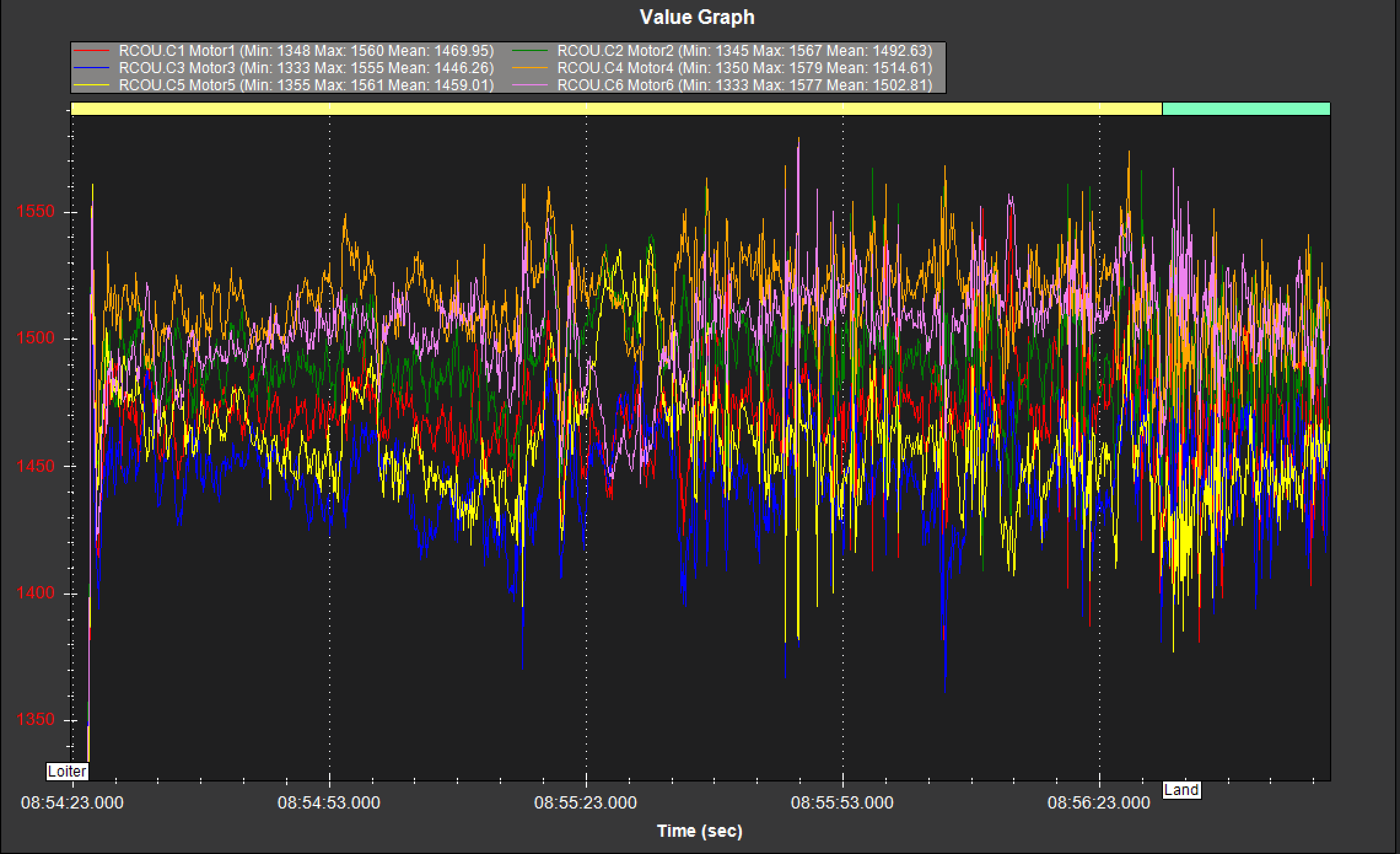

This is my motor outputs:
Are these oscillations acceptable? There was a good wind when I was flying it and I have not done the tuning so that might be the reason of oscillations I guess.

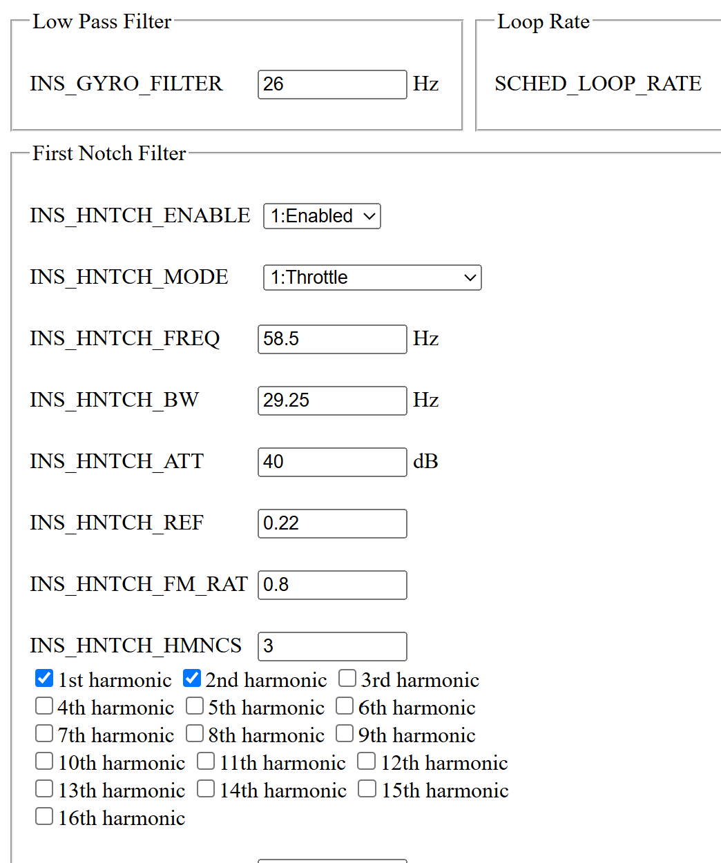

Have one doubt on Filter tools also:
So here I have taken the first peak value and then enabling the notch filter
I can change these values here (in the below screeshot) and then again recalculate the post notch filter and see how it works right? When I change the values the estimated notch filter values will change. Is that correct? My post filter values are whatever I have set in the drone. It does not have to do with the below values, below values will show the estimated values. Am I right on this?

Check the last IMU (2) it is the hard mounted one. If you have cube in the middle of large plate it may amplify Z-vibrations. Y-vibes are a bit high too.
@Vkk01 create a new thread with your AMC questions
I did not understand what point you are making here. Yes! the IMU (2) has more vibrations then other but has less Y-axis vibration comparable to IMU 0 & 1.
