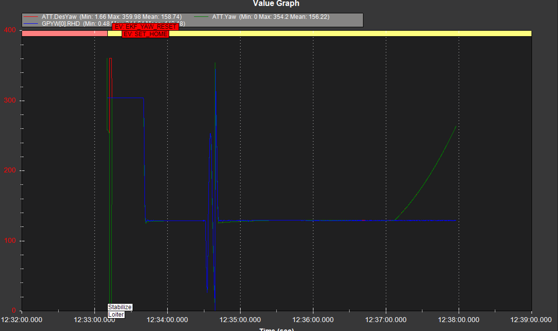

But here is the screenshot of the latest flight:
You can see how the GPS heading is fluctuating drastically during the flight. But interesting thing is it still maintain the heading even though I kept GPS as yaw source. How does this work?

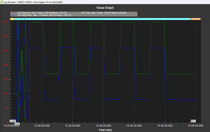

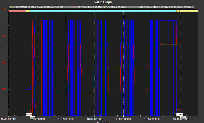

Here are the logs for the ground test: Ground Test Logs - Google Drive
My observation is:
Negative X axis configuration is showing good results in the logs but when I see the drone heading in GCS, it is not showing the correct heading. I checked with the compass in my hand facing along the drone heading direction.
My current configuration, which is negative y-axis is only showing correct drone heading in the GCS but in the log it is showing 90 degree shift between AHRS heading & GPS heading.
Can you please share some screenshot of your drone log with GPS for Yaw enabled? Is the AHRS heading & GPS heading match in your system?

Actually with the correct front facing orientation also it shows the same results:
Still it shows the same 90 degree phase lag.

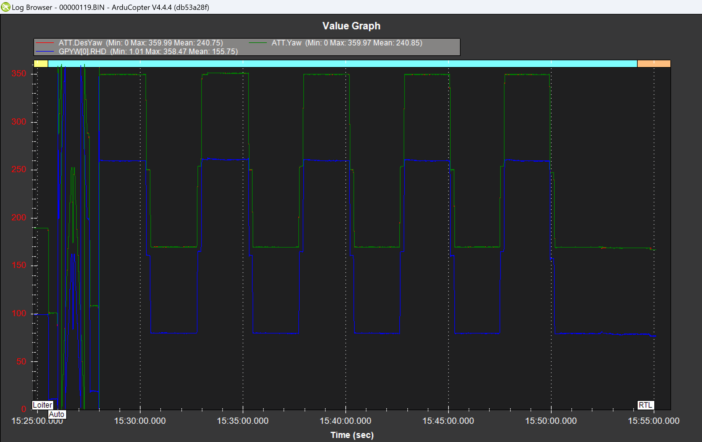

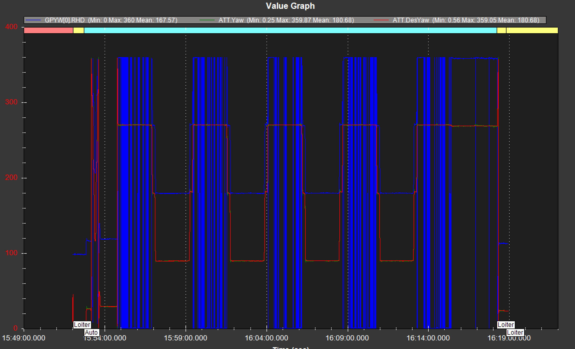

The GPYW.RHD (raw heading) shows the heading between the two antennas, which in your case, is indeed 90 degrees to the direction of travel.
If you look at GPS0.Yaw, this is the corrected yaw, and it does track with the vehicle’s yaw estimate.
Something wasn’t adding up for me, especially since your EKF innovation values aren’t wildly out to lunch. This was it.
I don’t think GPS yaw has a thing to do with the behavior we are seeing here. Your configuration is correct and has been correct the whole time, and we just went down a major rabbit hole as a result of my misinterpretation of the GPYW logged messages.
