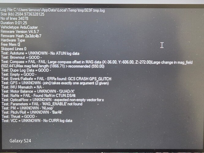

After did some changes inside my drone, i went for the test flight and during flight my drone was crashed(fliped same time during takeoff). when checked the log file found compass error. Please check the log file and photo of auto analysis and confirm the reason of crash. Surprisingly after fliping the drone not disarmed until i removed the power plug

I know this is compass error. But need to confirm why the herelink not warned me about the compass health
Auto Analysis is of no value it’s so far out of date. The “GPS glitch or compass error” came after, and a likely result of, the craft rolling around on take-off. Sure you got the motor order and direction right after making the changes you mentioned?
nothing changed except some Electronics and connector change. After did the changes i didn’t callibrate the drone.
Not much to see in this log but I don’t think it had anything to do with the compass.
Then what’s the reason of sadden fliping?
Pics of the copter before flying
It’s not clear from the log. On throttle up some motor outputs go to max and it starts rolling. That’s what can happen if the motor order or direction is wrong, or maybe a prop breaks but you would presumably see that.
Note where the error message is relative to when shit hit the fan.
Yes, soon after i put the throttle up it was flipped like wrong propeller direction. But the props are placed correct and the main thing is that if any thing was wrong the message should came in herelink. After the carsh the props are broken and it was not disarmed till i removed the power plug
