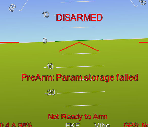

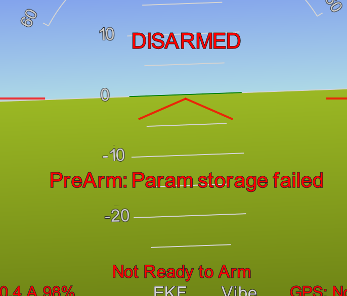

Then set logging when disarmed, as previously, and after pressing write param on messages I have this:
15.04.2025 14:42:15 : PreArm: Param storage failed
15.04.2025 14:42:15 : PreArm: Rangefinder 1: No Data
15.04.2025 14:42:15 : PreArm: Logging failed
15.04.2025 14:42:15 : PreArm: Battery 1 below minimum arming voltage
15.04.2025 14:42:15 : PreArm: GPS 1: Bad fix
15.04.2025 14:42:15 : PreArm: RC not found
15.04.2025 14:42:12 : AP_Logger: IO thread died
15.04.2025 14:42:10 : No ap_message for mavlink id (271)
15.04.2025 14:41:45 : PreArm: Rangefinder 1: No Data
Please post your parameters

Please set INS_GYRO_RATE back to the default - you are never going to get 4Khz on an F4
you might get 2Khz but not 4Khz
I just tried set it to 2kHz (INS_GYRO_RATE =1), reboot, set LOG_DISARMED=1 and same result.
But… despite INS_GYRO_RATE =1, on startujp there is still this line:
15.04.2025 15:54:03 : IMU0: fast sampling 4.0kHz/4.0kHz
Is that somehow downsampled to 2kHz, or param is not working ?
EDIT: It required powercycle to actually start at 2kHz.
Seems setting 2kHz solves the problem. I do not recall setting it to 4kHz, I wonder if that was default or not.
At least it arms properly without throwing any errors related to storage and iothread. Thanks.

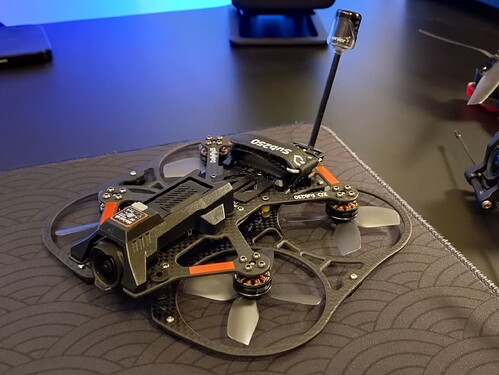

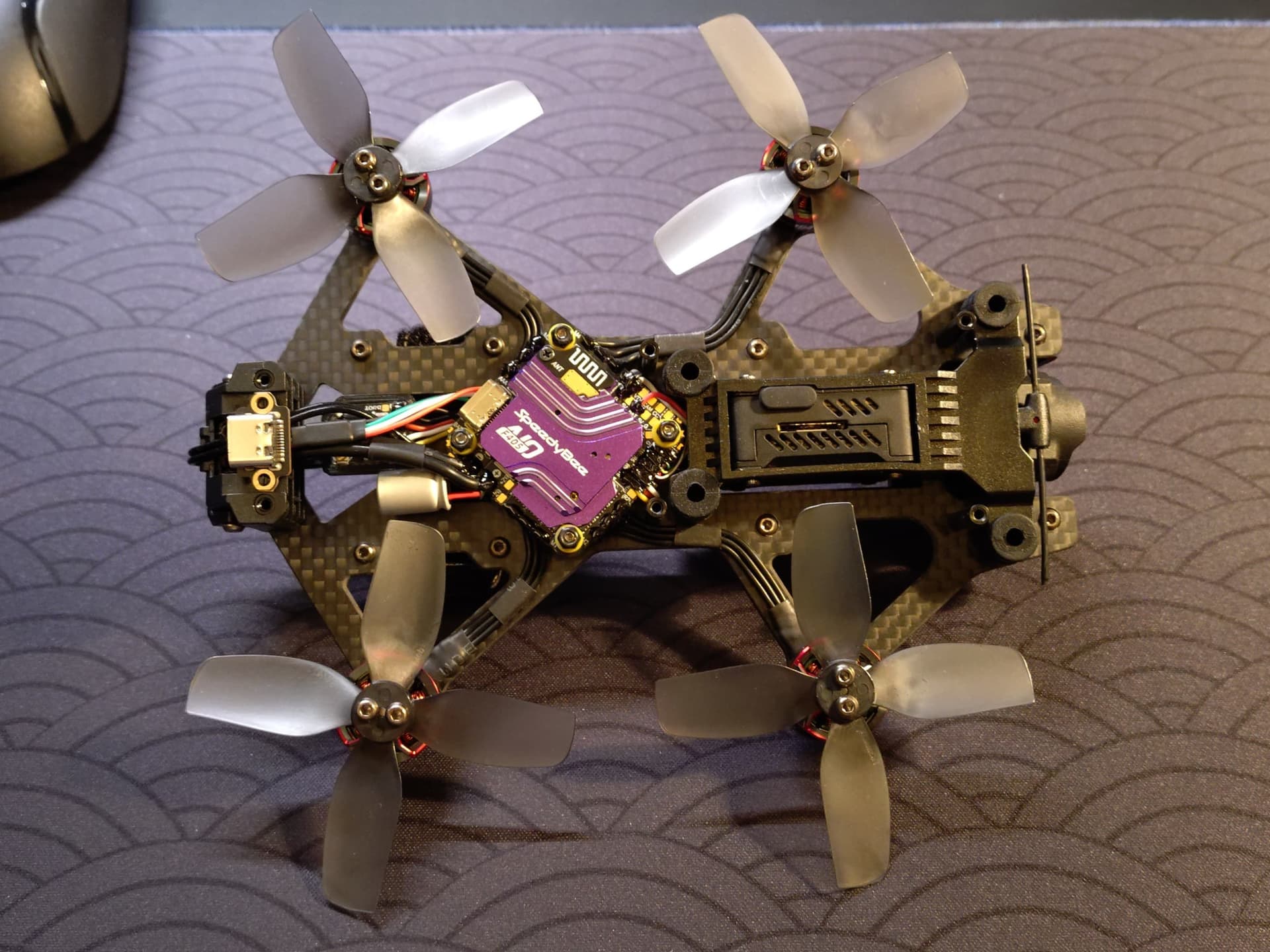

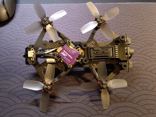

Sorry, a bit late to report. Flashed beta5 last week on SpeedyBee F405 AIO withSTM32CubeProgrammer using the with_bl.hex compiled using custom firmware builder (I left all features to default). Flashing with betaflight or mission planner in DFU mode did not work.
Mounted the board upside down on a sub250 2.5" cinewhoop, powered with 4s LiHV.
Tested flying in stabilize and alt-hold, I have not done proper compass calibration or magfit, but ublox got some sats (I use Flywoo M10 nano with compass). Logging seems to be fine, did 2 minutes flight to get batch sample, but downloading was painfully slow (about 2 hours).
Prior to this, I tried to compile beta4 using my own hwdef, tune the PID and flew it about 300m in the mountain in loiter mode. I fully erased the board when flashing beta5 and reuse the tuning value on this quad.
I use INS_GYRO_RATE=0 and DSHOT300. Will try to change this later and see if I have the same error with Adam. Here’s my current messages:
