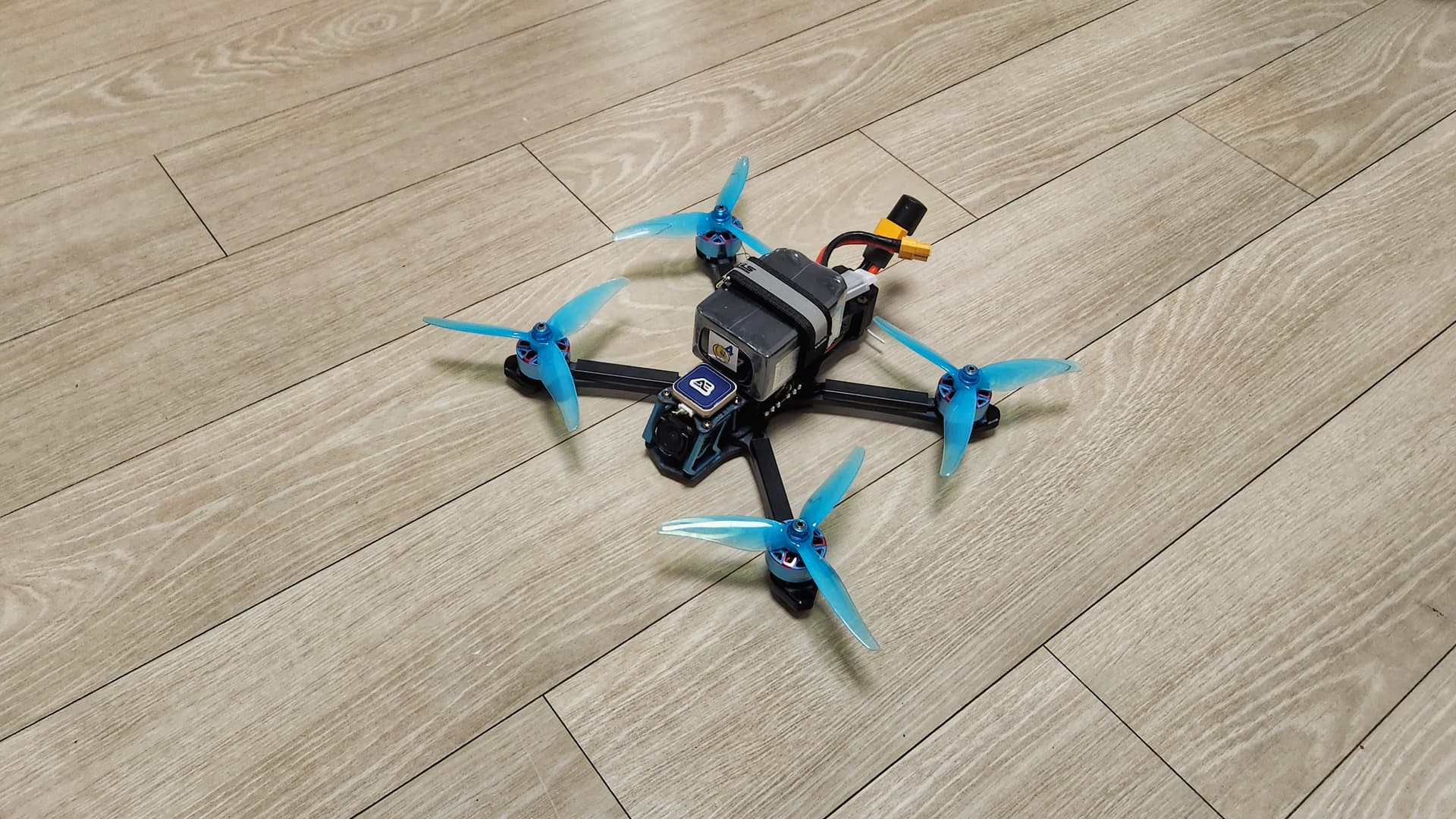

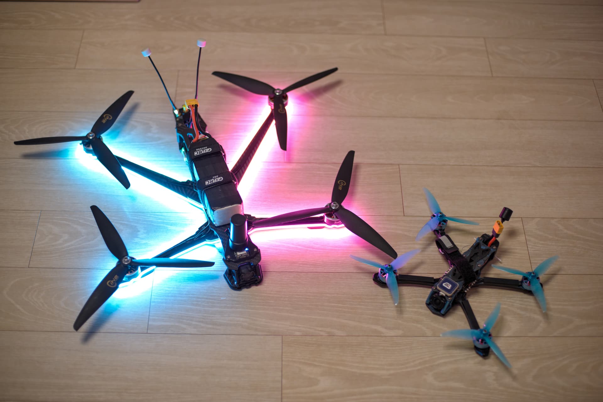

I built an Adupilot quad using a Microair 743 stack.
Wiring/appearance is no different from stylish quad configured with Betaflight or Inav!
MicoAir743 - Flight Controller - MicoAir Tech
Thanks both. I will read more about the other mentioned FC. The LEDs are looking nice. Can you list the other components you have used (for LEDs, ESC, Camera, Power Delivery for camera and the rest, frame, etc..)
Microair 743 FC has a connection port for DJIO3 (9V power output), so no separate power is required for VTX.
ESC used a 60A ESC purchased with a Microair 743. (STACK)
The small quad (5-inch) frame is the Axis Flying MANTA5 SE.

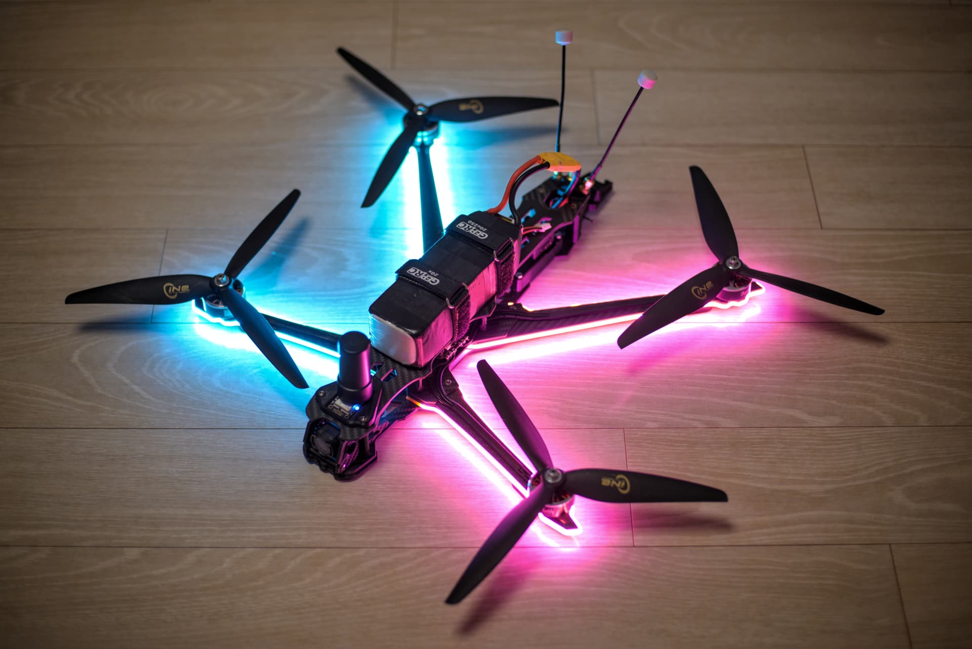

The large quad (10-inch) frame is GEPRC GEP-Pulsar LR10.
As for the LED, I bought a 12V COB LED from AliExpress.
