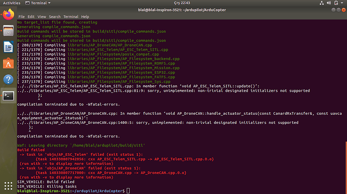

i have this error. İ downloaded all things. help me

Git submodule update --init --recursive

i tried its not worked
