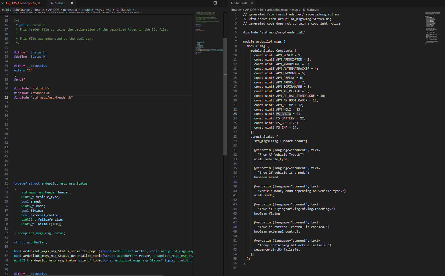

I am trying to connect CubeOrange with ROS 2 running on the Raspberry Pi - DDS appears to be the best solution, but the firmware must be compiled from source.
I fixed the wscript for AP_DDS as suggested by [wntun], but the compile process fails in AP_DDS_Client.cpp:682 with ā€œerror: ā€˜FS_RADIO’ was not declared in this scopeā€. AP_DDS_STATUS_PUB_ENABLED is enabled by default and it should include the constant FS_RADIO from ā€œardupilot_msgs/msg/Status.hā€. Any hint on how to make it work?
It appears as the constants are left out by the microxrceddsgen tool
Ok, I brute forced the constant values and included the definitions in the source file directly, the code now compiles, but I get the linker error 'cannot move location counter backwards (from …30591c60 to …30040000). The numbers don’t make any real sense, so I am back here for help…
